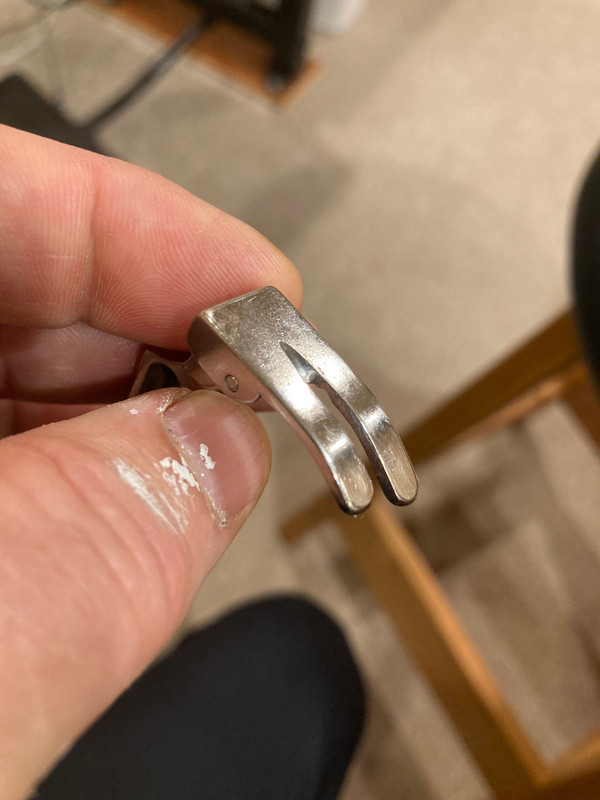

Members sandmanred Posted June 1, 2022 Members Report Posted June 1, 2022 Please post a photo of the bottom of your presser foot, I'll explain why. Here's my story and theory about what may be happening. I had a similar presser foot to the one in your video. I could get nice balanced stitches. But then when I'd change to another foot like a roller foot or zipper foot I had to back way off on the top tension. And then take the tension back up when I switched the foot back into the machine. I determined that with the foot like yours and going forward as the stitches get pinched between the presser and the needle plate and thus requiring higher tension than say a roller foot or zipper foot. In your case when you go in reverse the stitch just made is not under the presser foot so the tension set for going forward is now way to high for going in reverse. Here's a picture of what I did to resolve my problem. I filed a small relief in the bottom of the the foot like yours so that the stitch being formed doesn't get pinned to the needle plate by the foot. Now I can switch feet with no tension adjustments. I think this same relief could solve your problem. Quote Have Consew 255RB-3, Pfaff 545 H4, Chandler 217, Pfaff 138 and Merrow 60W. Had a Singer 132K6, Singer 78-3 Consew 28, Consew 18, Singer 31-15 and regret selling each and every one of them

Contributing Member friquant Posted September 15, 2025 Contributing Member Report Posted September 15, 2025 On 6/1/2022 at 8:42 AM, sandmanred said: I filed a small relief in the bottom of the the foot like yours so that the stitch being formed doesn't get pinned to the needle plate by the foot. Now I can switch feet with no tension adjustments. I like this! The inner toe on my Singer 144W103 has a (factory?) relief right there too. Quote friquant. Like a frequent, piquant flyer. Check out my blog: Choosing a Motor for your Industrial Sewing Machine
