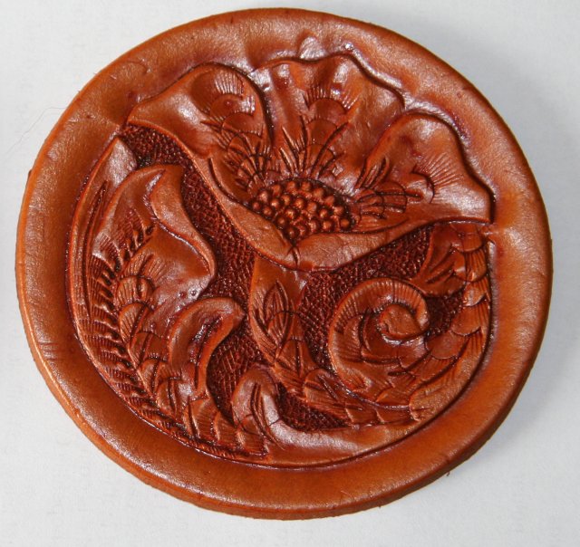

Members CitizenKate Posted November 20, 2007 Members Report Posted November 20, 2007 Has anyone tried the new Eco-Flo Gel Antiques? Just wondering how this formula stacks up... I've tried it on a few pieces so far, and I got very nice color and antiquing from it. The only thing I didn't like was how shiny it was after it dried, and I like a more mellow finish. Putting a wax finish over it softened it up. Kate Quote

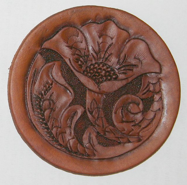

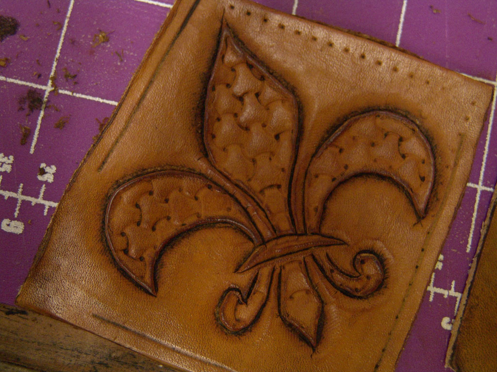

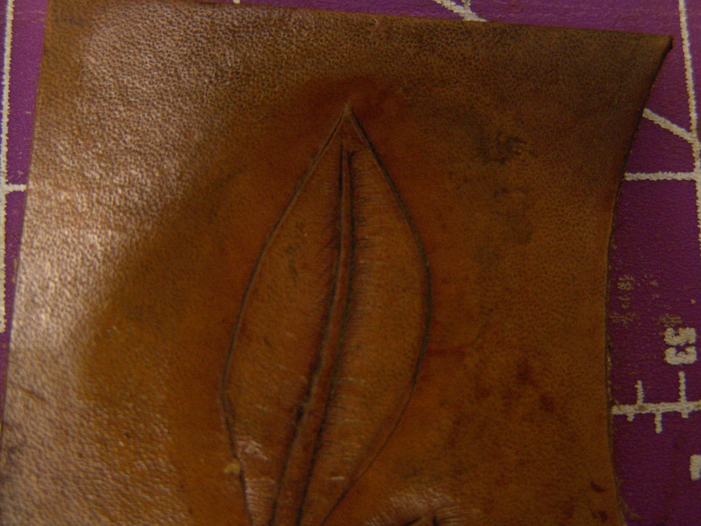

Members JustWakinUp Posted November 21, 2007 Author Members Report Posted November 21, 2007 Ok, I've followed some advice here with less than standard results. I'm hoping you guys can tell me what I'm doing wrong. The first image was treated with lexol, then stained with buckskin then antiqued with Med Brown then antiqued again with British tan. It appears that everytime I use the Med. Brown antique I get irregular black splotches & spots all over the piece. Here's an example This next image was not treated with lexol at all. It was simply rubbed with Med. Brown antique followed by buckskin stain. Notice all the splotches and spots an the irregular coverage. Any insight on this would be greatly appreciated. I then had a scrap piece i simply rubbed Med. Brown (fiebings) antique on and the same results with the spots and splotches. Any info on what I'm doing wrong? Quote
Members CitizenKate Posted November 22, 2007 Members Report Posted November 22, 2007 I will venture my best guess... Since (I'm gathering) the splotches appeared after the first coat of antique, we can probably rule out any interaction between the two coats of antique. Without putting down a resist before the antique, the antique can sometimes highlight the leather's characteristic flaws, as well as your tooling and carving. That is, there are areas of the leather that the antique will absorb into more than others. That's not necessarily a bad thing, but it does make working with antique a little different. Another possible thing to rule out is, could there have been something on the leather before you applied the first coat of antique that it is "sticking" to, or reacting to in some other way? If so, then maybe eliminating them is as simple as making sure the leather is very clean and free of contaminants (and completely dry) before the antique is applied. Another possibility - tanning flaws. I've had some leather that had some strange, light-colored areas that were barely visible before being treated, but when the antique hit it - HELLO! (I.e., Start over!) In those cases, maybe using a resist will prevent those kinds of splotches, especially if you're trying to get a smoother look on your leather after the antique. If you prefer a more natural or even a more distressed look, it may come down to learning to spot the flaws and avoid them. Hope this helps... Kate Quote
