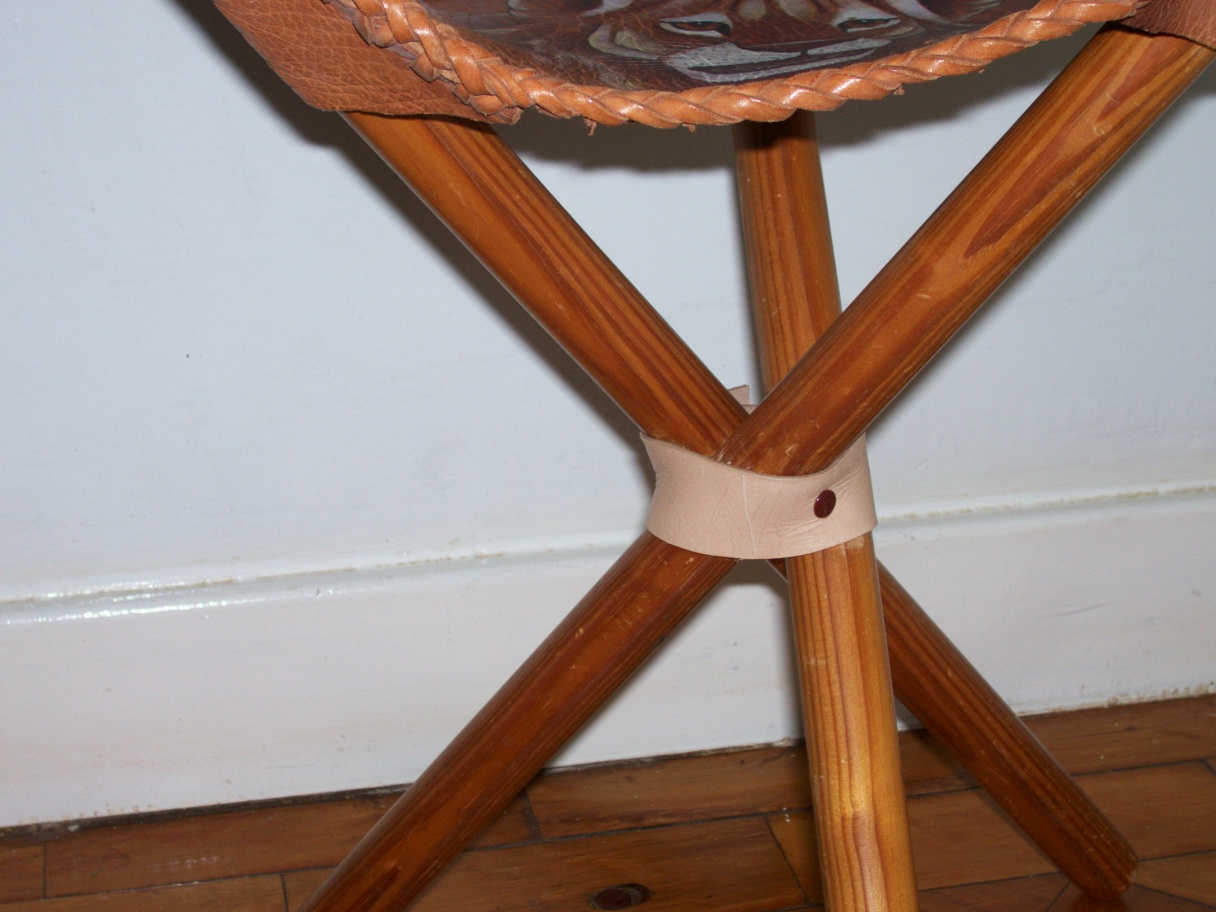

I normally have just had someone make them for me by welding 3 bolts together at 120 degrees each. . . BUT if you want a more "rugged" look you can use a piece of thick veg tanned leather in a circle (like a bracelet a little larger than the 3 legs together). Place the leather loop at the fulcrum point of the 3 legs (normally middle of the leg) To keep the leather "loop" from sliding up or down when legs folded straight you can put one tack through the leather into one leg. If you want to try this, let me know and I'll post a picture. Doug

Timbo,
I'm attaching 2 pictures. . . 1 is of how the 3 bolts look when welded together if you go that route. . . the other is of wrapping leather around the 3 legs. . . I didn't actually have a "nice" one with the leather wrap, so I just made one real quick and put 2 rivets in it so you could get the idea. . .it just needs to be a little loose around the 3 legs, then when you spread the legs, the leather wrap gets snug as they spread. . . you will want to make yours of thicker leather and to reinforce it more (even wrapping around multiple times).
You can even use a shoe string to tie the legs together, we had to do it while camping when the metal bolts broke. . . but the shoe string probably won't attract too many customers, heavy leather is much nicer! Doug
