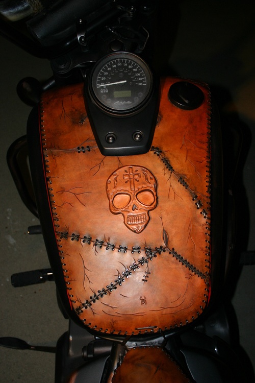

Those are way kewl, and look very comfortable. I like the bib, and the bag too!
  • Contributing Member
Thanks, I didnt do any bags, those are production bags, but I did the bib... reason it is so big is last winter I had her in the garage, and a 6 foot ladder fell... the very tip of the top corner hit the tank and put a decent noticeable dent into it...
