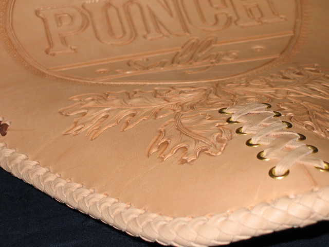

David Posted February 18, 2008 Report Posted February 18, 2008 If any of you have been around for a while I'm sure you've heard me complain about having to do the advertising seats for the bike shop that I work for. These are plain logo seats. Thin padding, no extra lace nothing on the seat but the company logo. I've been telling these guys for months that they need something else on the seats to get the seats back in the "custom" seat category.....an avertising seat just doesn't make it....besides they are boring to do. Here is a sample of what I'm suggesting, fancier basketweave around the seat, small amount of extra lacing, and some sort of art to go with the logo. This is the first of three that I'm going to do. We'll see how it goes. They've done a couple bikes recently with Victorian scrollwork gold leafed on the tank, I thought this would be a perfect fit for bikes like that. Anyway, here is the first of the three seats. If the artwork looks familiar, just chalk it up to being the very LAST entry in the oak leaf carving contest....ha ha. Dave Theobald Quote
Members Spider Posted February 18, 2008 Members Report Posted February 18, 2008 Wow David this is nice. I really like your seat suggestions. Your lacing is awesome and your tooling kicks ass. Is this already on a pan? Can I ask what foam you use for the seats? This is really nice and they would only win by using this. Quote From the insane mind of SPIDER... http://spiderflesh.com Myspace: Spiderflesh Facebook: Spiderflesh George
David Posted February 18, 2008 Author Report Posted February 18, 2008 Wow David this is nice. I really like your seat suggestions. Your lacing is awesome and your tooling kicks ass. Is this already on a pan? Can I ask what foam you use for the seats? This is really nice and they would only win by using this. Is this already on a pan? Yes, it only remains to dye and add final finish and it will be ready to go. The foam is neoprene closed cell 1/2" thick. From Foam and More, 1925 W. Maple, Troy MI, 48084. Phone 1-248-284-0002. Great people and fast service. This is the stuff used in lawn furniture and boat cushions. Dave Theobald Quote

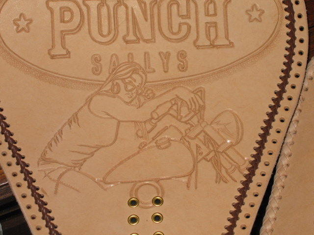

David Posted February 26, 2008 Author Report Posted February 26, 2008 (edited) Here are all three of these new seat designs. The girl seat is a photo from one of their ads. They also are using it as a poster give away at the shows. Any guesses as to how many he will reject? Oh sorry about the girl seat being unfinished. I've run out of lace....expecting more from Jim Downey. Dave Edited February 26, 2008 by David Quote
