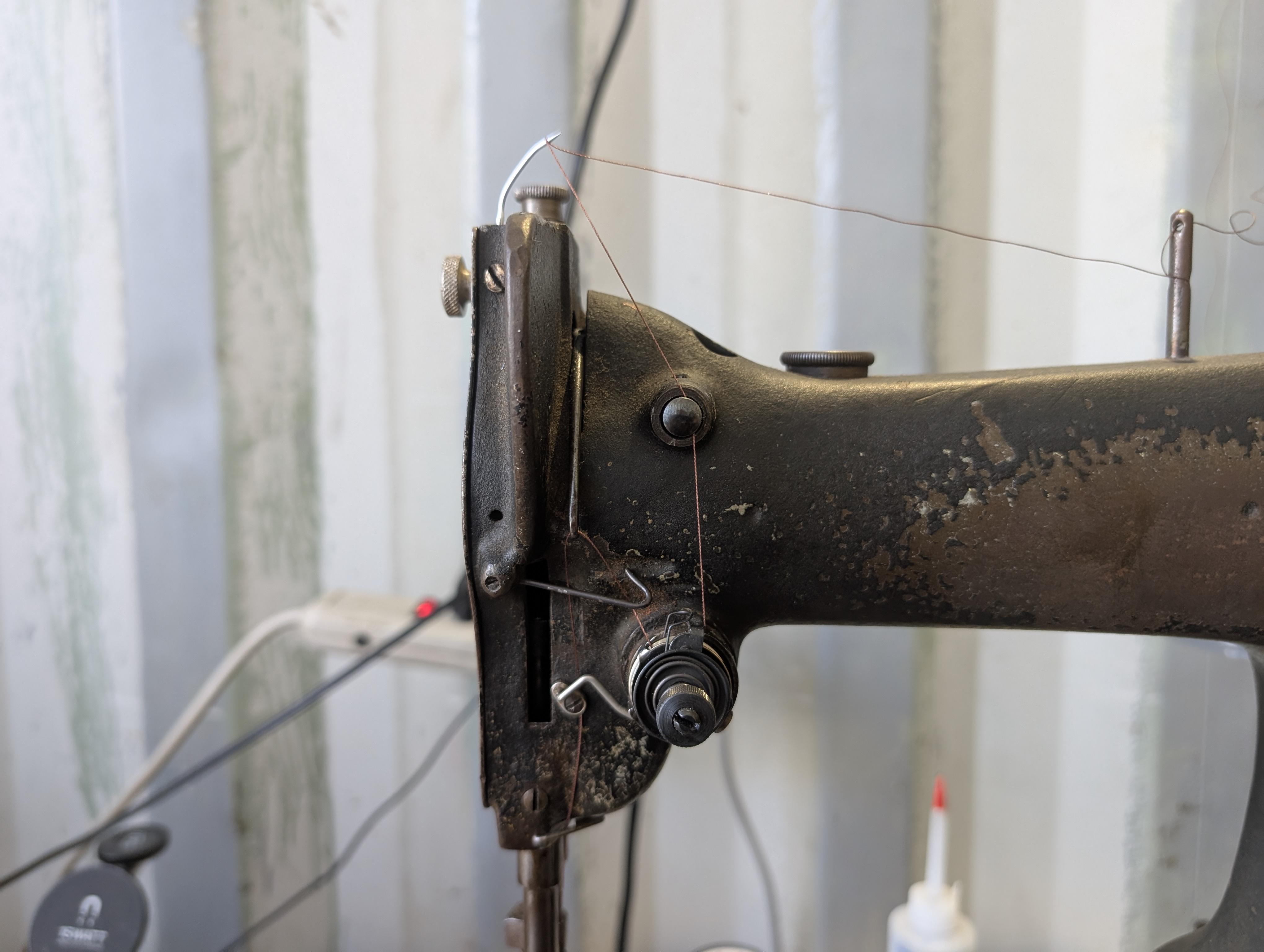

I finally got this machine set up. I was wondering. Did I get it threaded properly?
Edited by Northmount
Removed duplicated file
  • Moderator
First of all, what in the Sam Hill is that thing sticking out the top of the head? I've never seen any pin like that. Somebody added it to the machine.
Second, it appears that you haven't passed the thread through the check spring. You must pull the thread around the tension disks, then feed it through that spring, then up to the take-up lever.
Yes. I added that. On the manual it showed that it has a pin there but it was missing so I put a bent needle in the hole. It seems to sew better with it than without although now that you mention that it's not going through the spring that might be why.
Posted (edited)
some Singer machines have a crazy thread path and an "odd" / unnecessary thread loop or hole - don´t know why. My 108w20 also has this path and I do not follow it and it works w/o problem.
Beside that you have not instated the new tension unit correctly therefore the machine will not work properly.

Interesting. I thought I installed it correctly but I'll be the first to admit that I don't know that much about these machines. When you have time let me know how it should be. Thank you.
I can get you started. See that round spring pointing straight up on your tension unit? Right at the 12:00 position? It should probably be at about 10:00, straddling the thread. There's some other odd stuff there I won't comment on, but the check spring gets you started.
Edit: I think I see a set screw on the side at 5:00. Should be that  if you loosen it, you can rotate the check spring into position.

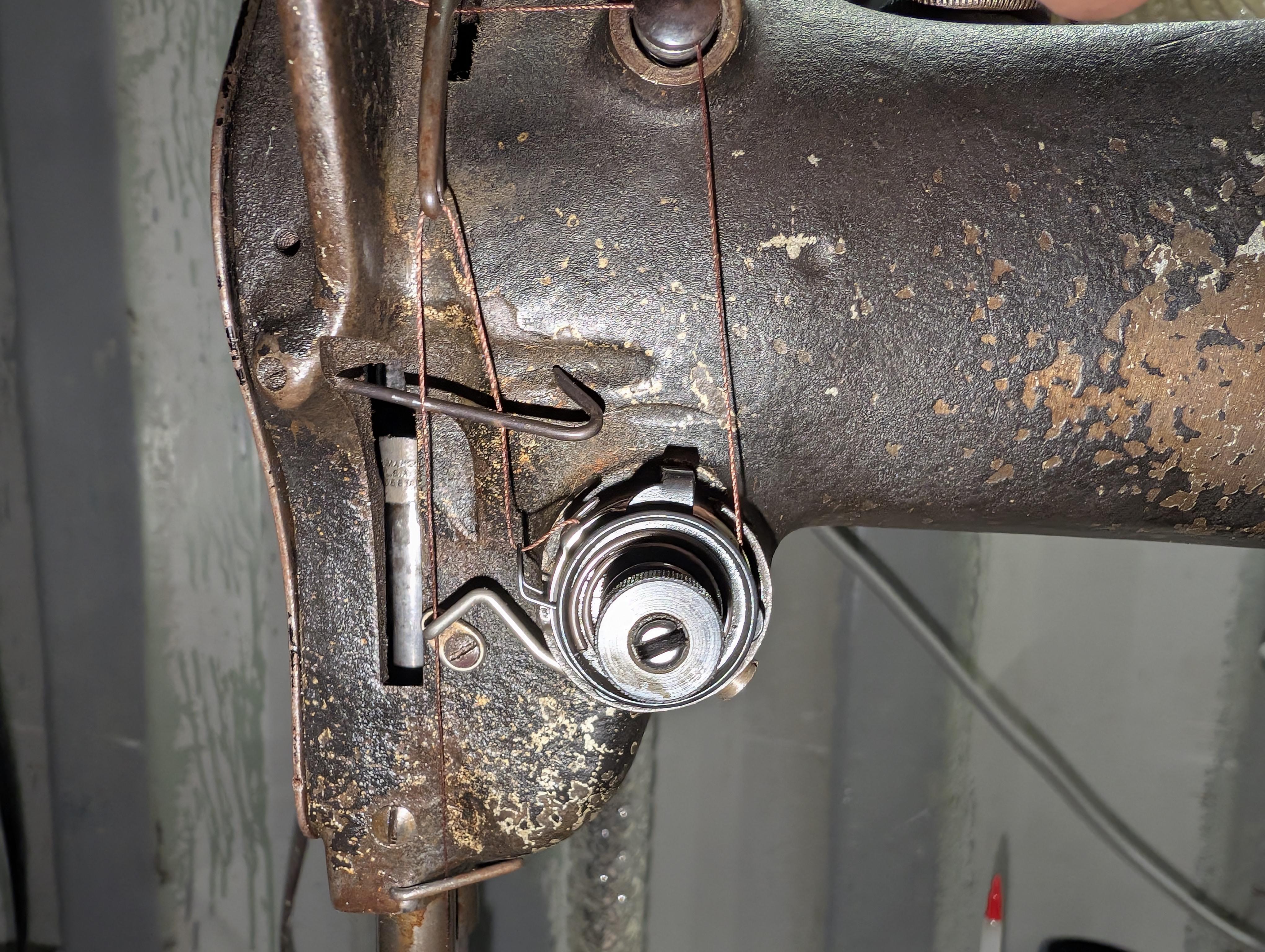

More like this then?
Yep, then the thread would be behind that finger pointing upwards at 11:00.
When everything is working right, you'd pull the thread around the disk and them pull it up until it snaps behind the finger.  Most threading videos for machines with an exposed tension unit will demonstrate it.
On the other side, where the thread enters the tension unit, it ought to be straighter and more taut, but it may just be loosely strung around there in the pic.
Making headway.
EDIT: Right at about 2 minutes of this video, Randy Your Sewing Machine Man demonstrates it nicely:

Posted (edited)
The check spring should rest in ~ the 9 o'clock position. There is a curved metal piece (A) underneath the tension unit that is secured by a screw (B). The end where the check spring rests on should be at approx 9 o'clock and the check spring needs a little pretension so when the thread lever goes down the spring goes back on the rest.
So, like this?
looks good so far - how ever some fine tuning could be necessary. Little hint - the thread should run above the thread lever and not under it.

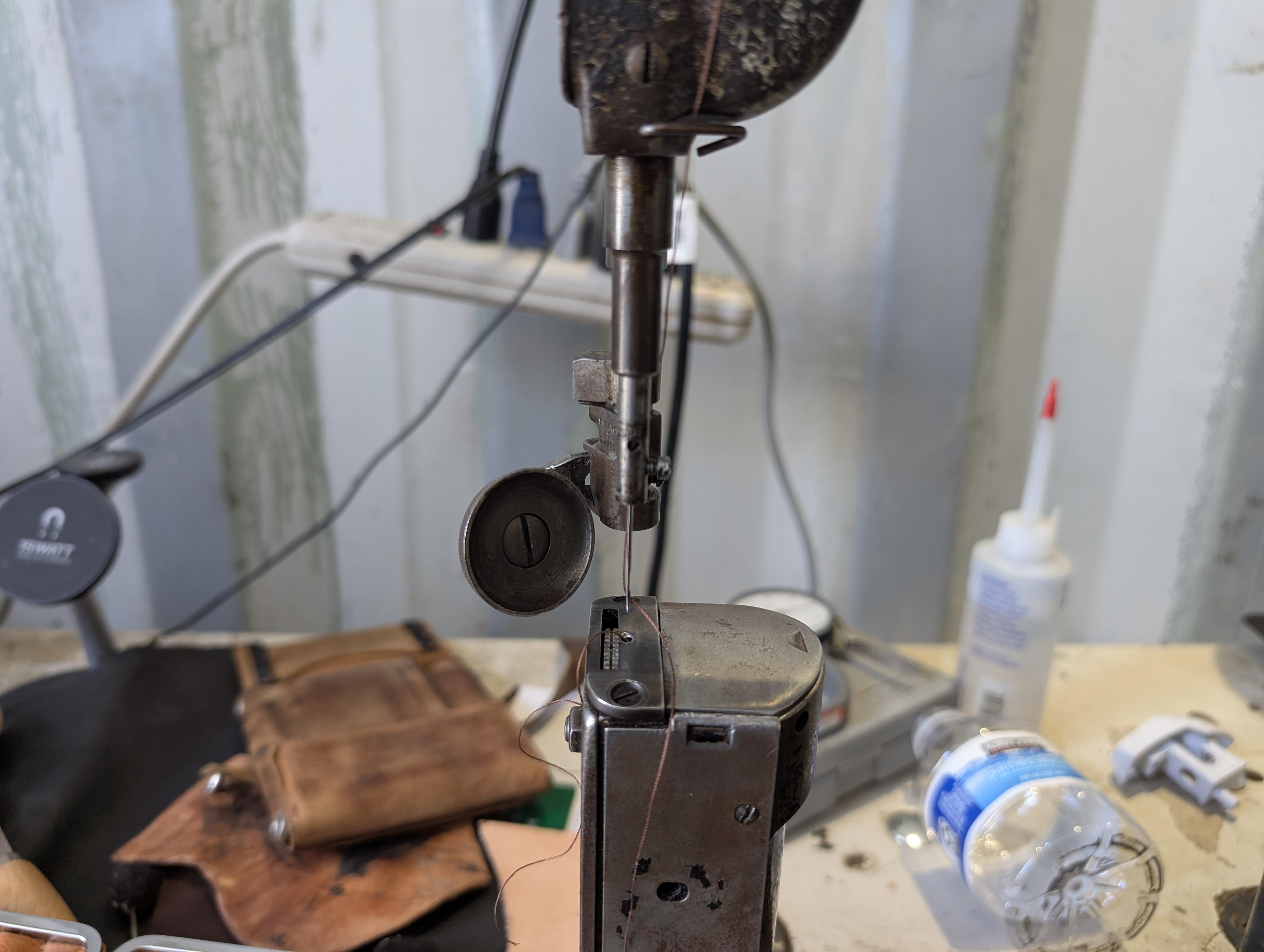

Thank you for all the information and help. This is how it's currently sewing. The white thread is thinner than the brown but it's the only other thread that was a contrasting color to see if my tension was right.
Posted (edited)
looks good, hope you have fun with this machine and it suits your needs 😃

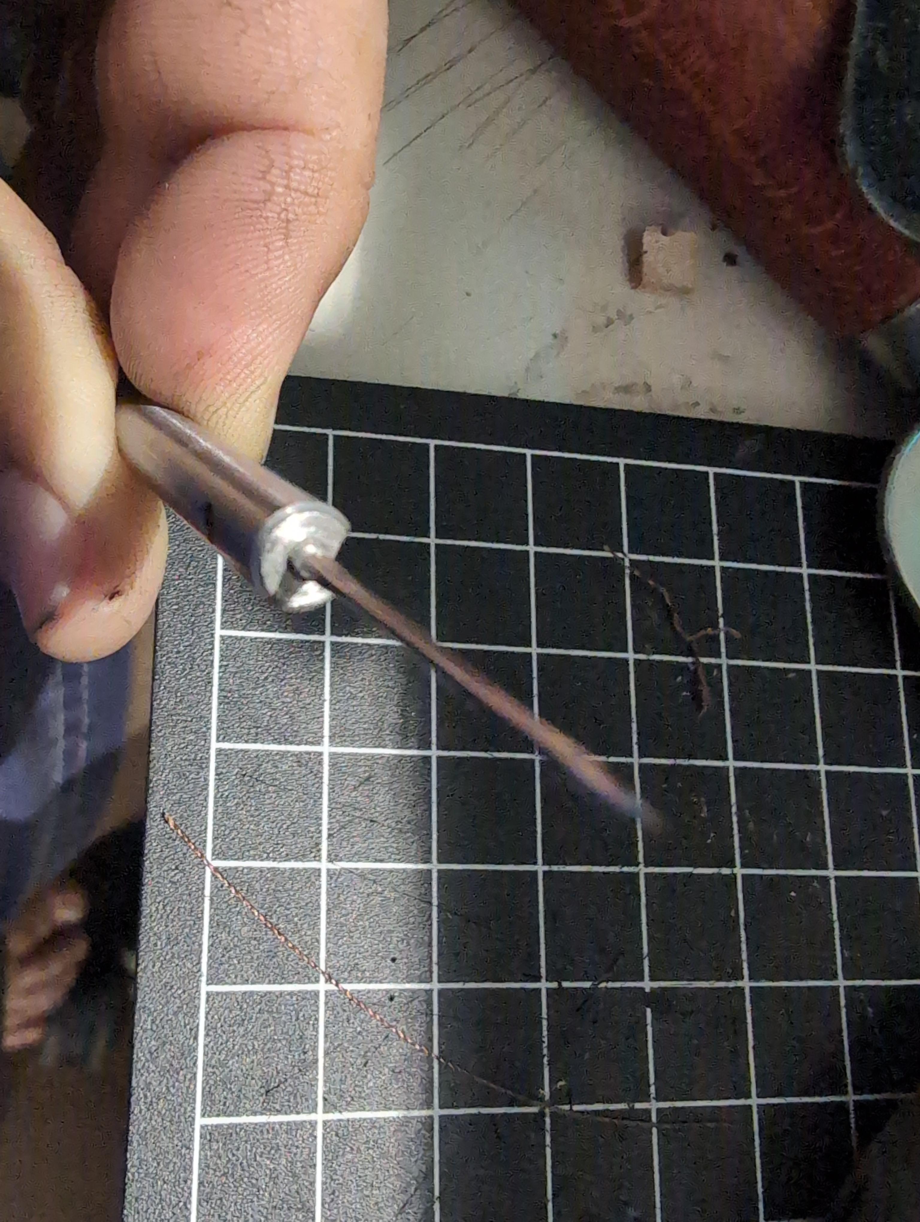

One quick last thing. I got the new needle bar to make the change so I can use larger needles but I realized that the one it already has on fits the same size needle and they have the same size opening. Seems like other than the length and age the needle bars are the same. I wonder if someone had already made the change.
The image shows the new needle bar I ordered and the current needle size that I'm using it fits seamlessly.
no one knows the history of this machine maybe one of the former owners had the same idea and change the NB some time ago. Who knows?
