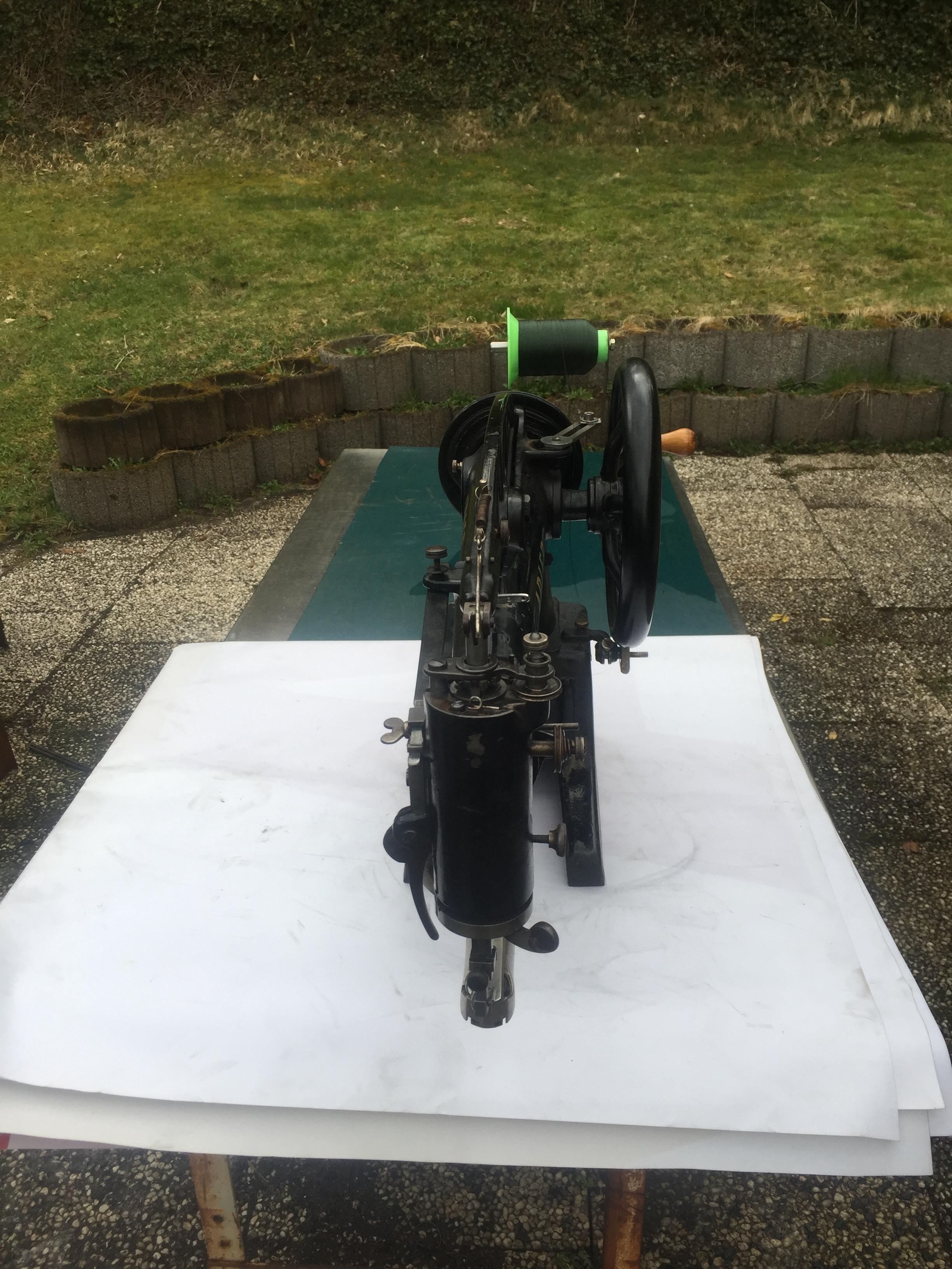

Members Tigweldor Posted March 24, 2025 Members Report Posted March 24, 2025 (edited) Bought this machine last week in Wuppertal for 55€. The sewing head had not seen oil for a long time - it was seized and had a broken part. So I bought a Singer 29K-51 for 20€ (with table) - although it had a broken off casting lip, where the take up lever for the presser foot mounts. BUT : the entire sewing head from the 29K-51 fits 1:1 onto the Adler 30-7 --- actually, had it not been for the broken casting and the missing lever - I could/would have converted the Adler 30-7 into an Adler 30-70 with the 29K-51 head. The main reason I bought the machine was because it has the larger bobbins - besides that it can´t do more than the 29K-33 that I have mounted on a motorized stand. If you mount the thread spool horizontal - you can use the bobbins with a cone foot - they will not fit the stock spool holder and will also hit the arm if you force them to fit - then they do not turn freely. The only thing I have yet to fix is that the foot take up lever drops down too far and thus blocks the rotation of the sewing head - but in the last pic, I took up all free play by hand - I just have to weld something to the lever end so it does not slide into the slot of the head casting and all will be good. Edited March 24, 2025 by Tigweldor Quote

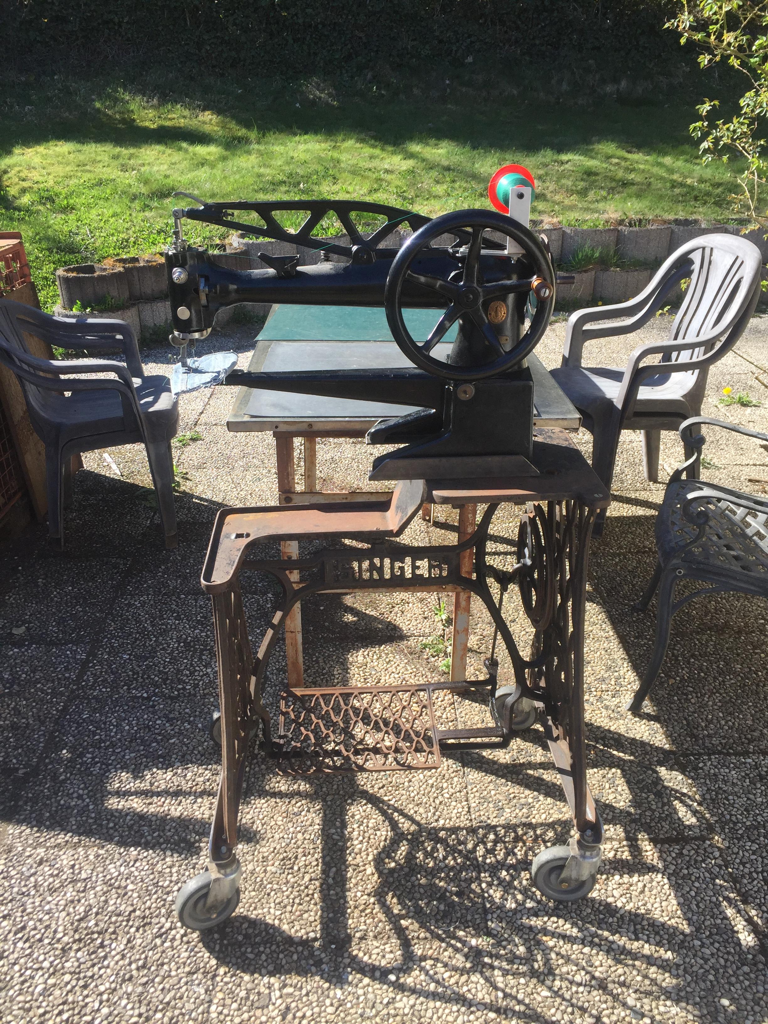

Members Tigweldor Posted April 4, 2025 Author Members Report Posted April 4, 2025 (edited) Here is what the Singer 29K33 looks when mounted on the way to short treadle table of a Singer 29K51. I did follow CowboyBob´s suggestion and used angle iron - sure moves the working end of the 29K33 far to the left - but heck, for 20 Euros the table came with the "spare parts 29K51" - so I guess this is better than a kick in the butt - once in a while a guy has to improvise/accept less than optimal results until I find a right size treadle table on my journeys. Still waiting for a leather drive belt. Angle iron is 40 x 40 x 5 - spacing is 268mm for the leg holes and 158mm apart. Used counter sunk screws for the other/middle 2 bolts to secure the angle iron to the table - they sort of self tighten/hold the head when tightening the nuts from underneath - can´t get a wrench in between angle iron and machine to hold them otherwise, once the machine sits on the table. I also had a spare set of shopping cart wheels lying around - so I also used some angle iron under the feet, cause the wheel trestles had to be secured with M10 bolts - would have left the little 100+year old cast iron foot-pads weakened. Spacing of the holes middle of foot to middle of foot is 440 mm. Secured the angle iron to the foot pads with M6 Allen bolts and self locking nuts. Do round off all the edges of cut to length angle iron - especially in/around the foot region - sharp 90 degree corners can leave nasty cuts on legs/ankles and this chore does not take much time. Since shopping cart wheels do not have a brake - I will install thumb screws on the sides of the 2 front trestles to keep wheels from turning when machine is in place. One thing I can sure state : the machine moves way better with the larger wheels than with the small "furniture casters" that I have installed on my other machines - and all of my sewing machines are mounted on wheels - saves having to lift them around when you have to move them - and below sewing machines it seems to magically attract dust and all sorts of fluff - easy to move them for cleaning the floor. Also made another a bracket to mount thread cones to the machine - the stock spool holder is to small for the cone foot and places it to close to the swing arm - very sub optimal. The Adler 30-7 is now mounted onto my custom table with the gear motor and VFD. Foot mounting holes are absolutely identical on the 29K33 and Adler 30-7 Edited April 4, 2025 by Tigweldor Quote
