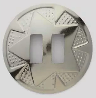

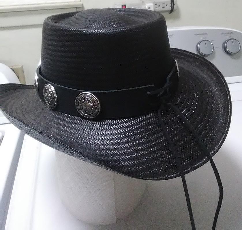

Members Rockrz Posted March 24 Members Report Posted March 24 Wasn't sure which forum to put these question in.... I'm wanting to make my own hat band similar to the Donnie Van Zant hat band (see pic below), and I've already ordered some 1 1/4 inch Silver Slotted Star Conchos, and a black Buffalo Hide Leather belt that is 1 1/4 inches wide (see attachments for pics) All I still need is some leather that is flat black that's fits in to the slots on the conchos and some leather working tools to be able to punch a rectangular hole in the leather belt I'll be using. I'll just run the thin leather strap thru each concho thru the holes in the belt where it will run on the back side of the belt all the way around where I'll have to figure out a way to fasten the back where the two ends come together. Questions... 1) Where can I find a tool that is rectangular shaped once I find the exact size I'll be needing (I'll know once I measure the slots) 2) I was thinking of somehow tying the thin strap that will be routed thru as slotted concho where it all comes together in the back of the hat... so what are some ideas on how to do that? One of the attachments to this message is a pic of the hat band I'm wanting to re-create since I cannot find anywhere that this can be purchased by itself without also buying the hat too which is pretty expensive Quote

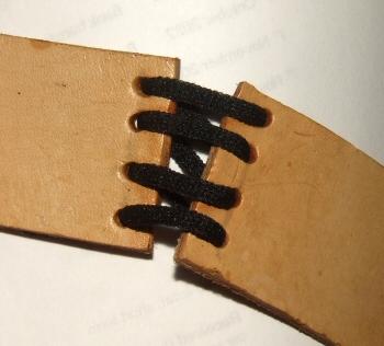

Contributing Member fredk Posted March 25 Contributing Member Report Posted March 25 I assumed the OP was intending to use a buckled belt as that was what he showed For information; these are some of the closures I've used; On a concho ed repurposed belt; a buckle with a large keeper Lacing, which went through the antler tips to hold them on, then criss-crossed. Enuf lacing so the band can fit on a larger hat This one uses elastic cord glued to the band. Enuf elasticity to expand to fit a larger hat Quote

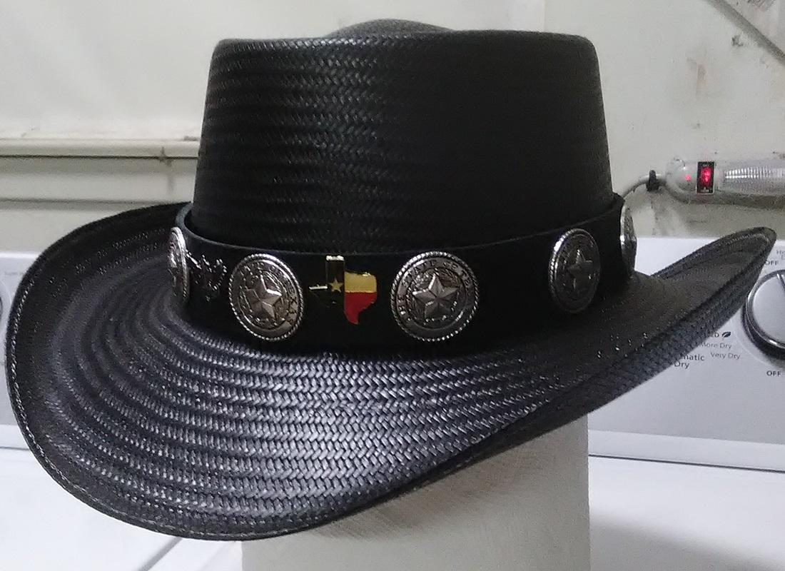

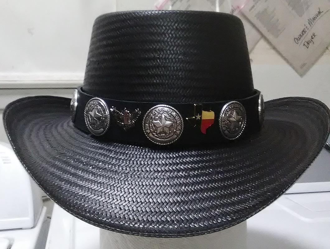

Members Rockrz Posted April 14 Author Members Report Posted April 14 (edited) Will be going back to the slotted conchos as I still want to duplicated the Donnie Van Zant hat band. But meanwhile... 04/02/25 First hat band made (turned out pretty good!) used... 1-1/4" The State of Texas Concho Double Rivet Back mounted on to 1-1/4" wide 5-6 oz. (2-2.4mm) Black Leather Belt Blanks The look is kinda similar to the Donnie Van Zant hat band Edited April 14 by Rockrz Quote

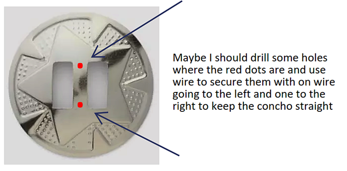

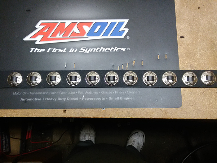

Members Rockrz Posted 2 hours ago Author Members Report Posted 2 hours ago OK, so I finally put together the hat band like the Donnie Van Zant hat band, but looping the leather thru the holes in the conchos don't hold the conchos very tight and they move up and down a bit. The holes in the conchos are 3/8 inch so maybe I need to go with a larger leather strap... which would be the next size up from 3/8 inch? From the pic below it doesn't look too bad, but in real life when I put this hat band on my hat some of them look uneven. When I was punching the holes, it was kinda hard to make them all perfectly straight. Maybe that was just me. I was wondering if there was a way to use some wire to attach the concho to the leather strap maybe one on the upper side and one on the lower side wrapped around the center section of the concho, but I'd have to figure out a way to make the holes straight somehow If I used wire to attach them, the leather strap I install would cover up the wire. Anybody ever attach conchos with wire and twist it on the back to secure it? Quote
Contributing Member fredk Posted 2 hours ago Contributing Member Report Posted 2 hours ago You could try using a wet strap for the conchos. Pull it up tight wet. Then when it dries out it will be even tighter Quote
Members Rockrz Posted 1 hour ago Author Members Report Posted 1 hour ago 31 minutes ago, fredk said: You could try using a wet strap for the conchos. Pull it up tight wet. Then when it dries out it will be even tighter I never thought of that but it makes sense that it would be tighter. How long to soak the strap in water? Maybe over night? Quote
Contributing Member fredk Posted 49 minutes ago Contributing Member Report Posted 49 minutes ago Naa, it should only take a few minutes, 30 mins at most. Use warm water, with a tiny wee bit of dish-washing liquid soap in it. After soaking stretch it along its length in your hands, squeeze out excess water then lace it through the holes. As it dries it will stiffen up and shrink a wee bit tightening up You can do this whether the strap is dyed or not Quote
