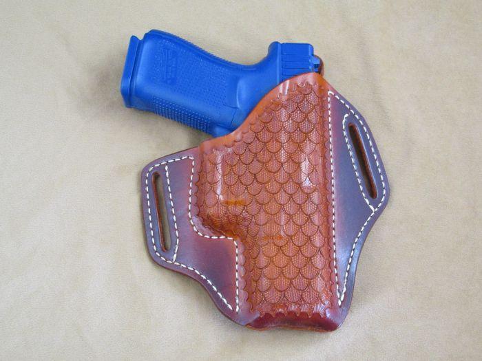

Members Dwight Posted April 26 Members Report Posted April 26 On 4/26/2025 at 4:07 PM, AlZilla said: Blue Guns, Dummy Guns and purchased patterns only get you so far. Nothing beats real world testing and evaluation. Maybe this is a good reason to buy one of every gun for which you're asked to make a holster. Expand Actually you don't have to have a real gun . . . but you have to have realistic models . . . or at least stop and look at pictures before you go at the holster. Simply laying the holster over on it's face . . . and looking at the same side of the gun should have shown the hole that was needed for the mag release. I use wooden dummy guns that I've made myself . . . but I am very careful about the mag releases and safeties . . . on wooden guns . . . they are absent . . . on blue guns they are at least visible. May God bless, Dwight Quote If you can breathe, . . . thank God. If you can read, . . . thank a teacher. If you are reading this in English, . . . thank a veteran. www.dwightsgunleather.com

Members Dwight Posted April 27 Members Report Posted April 27 On 4/27/2025 at 3:53 AM, DoubleKCustomLeathercraft said: Maybe it's only happening when he moves a certain way. Expand Actually I got a first hand lesson on this problem . . . and it was as you stated above. I went to a gun shop that was having a big sale . . . and holsters were like 50 % off . . . this was before I started making them. I had been looking for a certain brand of paddle holster for a full size 1911. He had one . . . and seemed really relieved when it went off the shelf. It was the color I wanted . . . and everything. I wore it a couple times out away from the house . . . and one day I grabbed it to go after a coon that was in my chicken house. I shot at him with the one that was in the chamber and missed . . . but when I went for the follow up shot . . . it just went click. As I looked at my gun . . . the mag fell out. The bandit got away. I took it in the house to try to find out what went wrong . . . exactly the problem you described . . . the hole was too small. Now when I do a holster for a semi auto . . . the mag release gets special attention . . . LARGE holes are left so they don't get inadvertently punched. And please be careful . . . some of them have releases on both sides . . . not many . . . but a few. Have fun . . . holster making is a challenge . . . and one I love to work in. I hope you enjoy it as much as I do. May God bless, Dwight Quote If you can breathe, . . . thank God. If you can read, . . . thank a teacher. If you are reading this in English, . . . thank a veteran. www.dwightsgunleather.com
