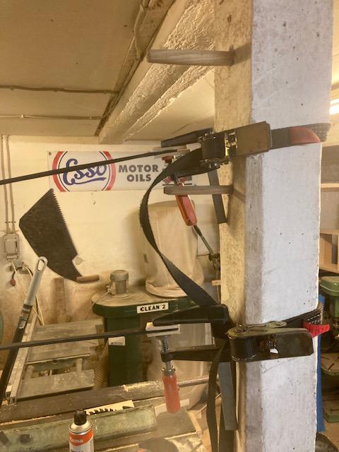

Members Mulesaw Posted Wednesday at 04:56 PM Members Report Posted Wednesday at 04:56 PM I had repaired a set of sliding reins for the stables where Gustav works, and I got inspired to make a set of sliding reins myself. The reins measured 2.5 m each (about 8' 4"), and they are basically just a strap of 5/16" leather with a carabin hook in one end and a buckle in the other end. So a very doable project. The hechte that I had was only 7' 4" long, so I needed to stretch it a bit to be able to get the desired length including bends around the carabin hook and the buckle. I soaked the straps in water for about an hour or so and left them in a plastic bag for casing during the rest of the day. In the evening I made a setup that allowed me to stretch the strapos uniformly. I clamped a small G clamp (woodworking clamp) on each end of the strap. I put small pieces of wood between the jaws to protect the leather a bit. The clamps on one end were tied to a post in the workshop, and the clamp on the other end was attached to a truck type lashing strap which was connected to another post. This gave me the opportunity to stretch the straps by slowly tightening the lashing straps. I alternated between the two straps, and occasionally I would release and reposition the lashing strap. Once I had reached the correct length, I stopped and let it sit over night. The next morning the leather had stretched and dried, so I could make the sliding reins (I forgot to take pictures of those) Quote

Members Mulesaw Posted Wednesday at 06:14 PM Author Members Report Posted Wednesday at 06:14 PM @Gezzer @Samalan Thanks for the nice comments, It worked like a charm. I forgot to write that I cut the straps a smidge wider than the 5/16", so that they would end up being the correct width after stretching. Brgds Jonas Quote
