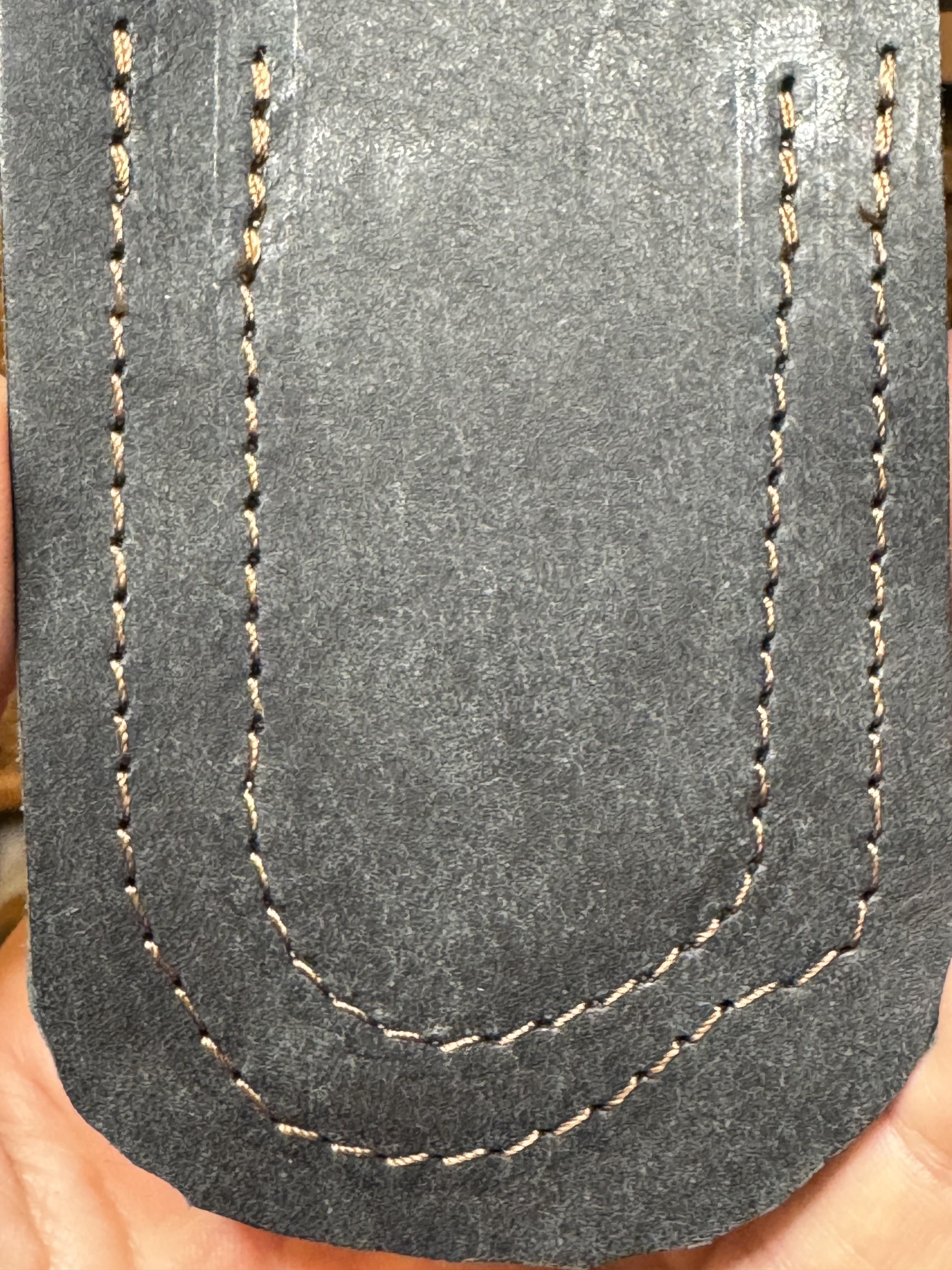

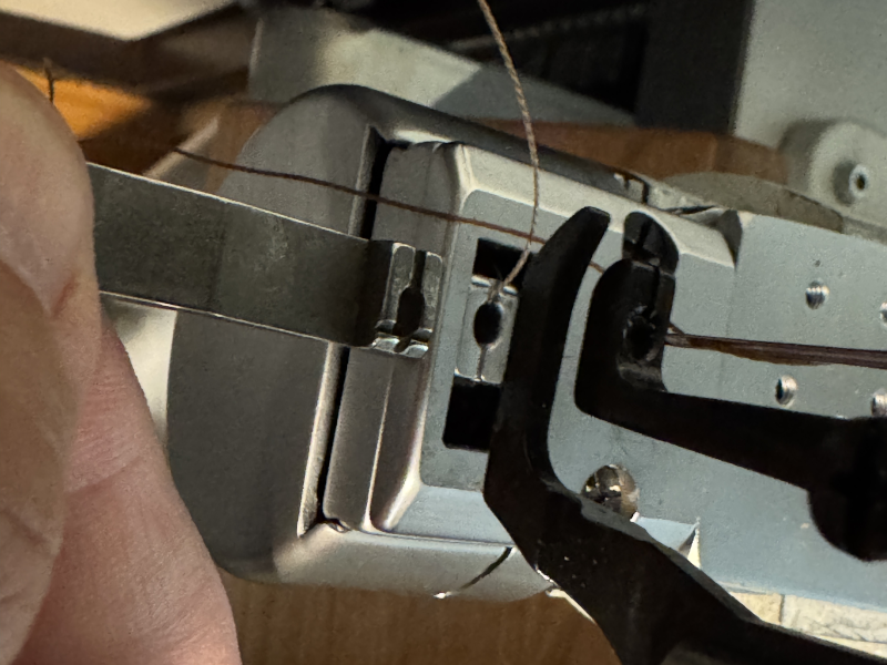

I got the replacement doggy thingy for my Artisan 246. The problem I am having is that the hole in leather is very large even with smaller needles. Someone said the hole in my dog feet thingy was too big so i bought another one. Looking at it, it does not look much different. What do you think, should I change the part on the machine? Would it be worth it?

I dl'd them despite the risk. They seem very similar size hole. New one has a slot...not really sure what the difference in use is?? I think I posted that Juki still sells the $200+ thin material feed dogs with smaller feed dog hole but I'm not sure that is what you need.
I also have a 246 so I am taking notice.
IMO, changing to that feed dog will not have any difference in the hole size of the material. The needle makes the hole, so maybe using larger thread to fill the hole. *Sorry i do not remember the original message board thread so something like this may have already been mentioned.

I already changed it and, as you said, it made no difference with the size of the hole in the leather. Could you show me a photo of the hole in the feed dog of your 246?
It is strange because I leather purses out there sewn with very thin thread, must be v92, and the hole left by the needle is unnoticeable. Mine is always very visible.

The outer line is done with the #16 and a thread a bit larger than the v92. The inner line is the same thread with a #19 needle

When you click on the manual listed for Artisan 246 it gives you the manual for the Juki DSC-246, The manual states that the part number for the 246 feed dog is #21135009 and the other one numbered 21134101 is for the 246-7. Buying another one or installing another one will not buy you anything as they will be the same.
I agree. What determines the size of the hole is the needle size and shape of the needle tip.
The leather looks like a thin leather. Have you tried 2 or 3 layers of leather and comparing the stitch quality. What I think maybe contributing to the problem is:
i) the leather isn't stiff enough or thick enough so it is not forced down into the feed dog hole or to hide the bottom thread knot properly
ii) stitch length maybe a factor so I would increase the number of stitches per inch
iii) change the needle from a LR needle point to a S needle point as the LR gives a off centre opening while the S is inline. ( https://www.coats.com/en/info-hub/all-about-needles/ )
