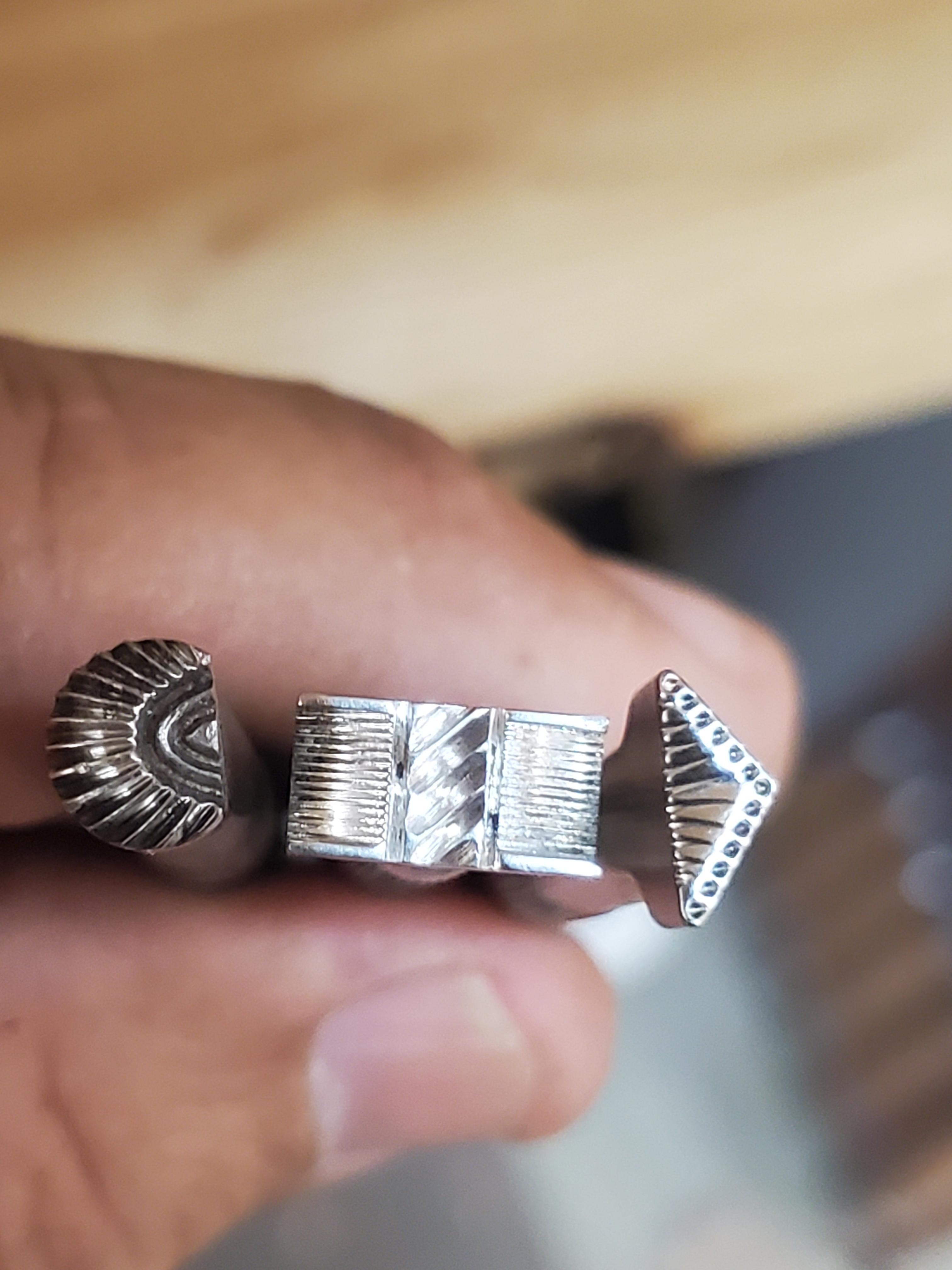

Moderator bruce johnson Posted June 3, 2025 Moderator Report Posted June 3, 2025 It has been mentioned on the forum a few times but not as a stand alone discussion topic I can find. A friend and I were talking about this a few days ago. There was a somewhat standard back in the day shared with us by older guys who stamped production work for large shops. After looking a bunch of the older work from saddles to wallets, it generally runs true. It makes for a pleasing visual outcome. Basket stamping - The width of the border stamp should be the width of the end of the basket stamp. Geometric stamping - The width of the border stamp should be half the length of one side of the stamp impression. Two impressions per side. Larger border impressions overpower the stamp pattern and smaller borders lose effect. Whatcha think? Quote Bruce Johnson Malachi 4:2 "the windshield's bigger than the mirror, somewhere west of Laramie" - Dave Stamey Vintage Refurbished And Selected New Leather Tools For Sale - www.brucejohnsonleather.com

rktaylor Posted June 3, 2025 Report Posted June 3, 2025 (edited) I think that is a good starting point. Chuck is right about finding things visually appealing. Some things just look better and some just don't seem right. This is my 'medium' basket weave stamp and my 2 favorite border stamps. Randy Edited June 3, 2025 by rktaylor Clarity Quote
Members MarshalWill Posted June 5, 2025 Members Report Posted June 5, 2025 Good information. I generally follow Bruce's rule(s) depending on other variables, of course. rktaylor, my all favorite border stamp is the same Hackbarth one you show on the left. I have a few others but that one I use more than others. Quote
