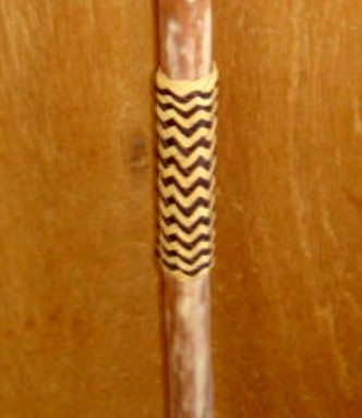

Members Sidney Wood Posted April 24, 2007 Members Report Posted April 24, 2007 Jim; Thank you for the kind words (David also). You are right about knot theory involving some heavy math but the one expression from lesson two is all you really need for a simple turkshead ( casa coded ). Done mentally it gives you some idea of what to expect before you start a particular knot. I found it in Tom Hall's book as the basis for an algorithm-diagram which I still have not figured out, but it predicts the first wrap or two of the cylindrical flat braid pattern. Actually you can braid any knot of this kind by a visual inspection as you go. The pinned mandrels help keep things organized and in place so you can concentrate on the braid pattern. The concept of the bight increment is the key to the whole thing and this is obvious from a template of the knot. I have a fourth lesson in the works that will be on the site in a few days. You mentioned pineapple knots earlier. I use method for interweaving two turksheads for a pineapple knot that I do without really thinking about it and as soon as I figure out a way to explain it so it makes sense I will put it up also. The attached picture is a long one on a hiking staff with a foundation of twenty something bights (I don't remember exactly how many). Sidney Wood Quote
