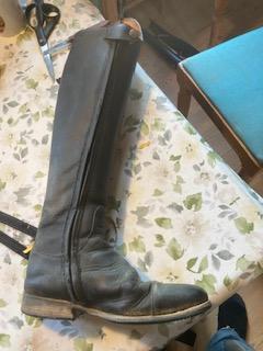

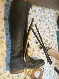

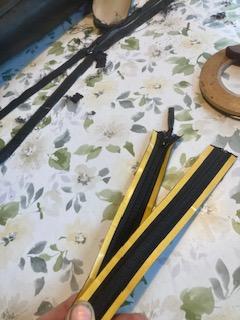

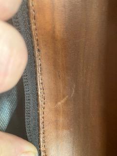

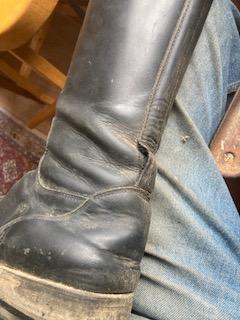

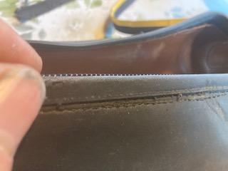

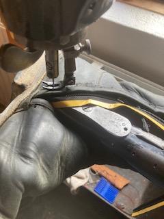

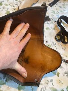

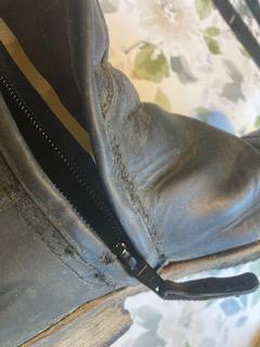

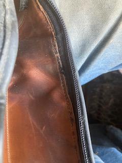

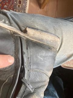

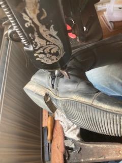

Members Mulesaw Posted July 2 Members Report Posted July 2 This tutorial is aimed at replacing zippers in riding boots, but the basics are the same in case you need to replace zippers in e.g. motorcycle boots or fashion boots. Materials & tools needed: - A zipper of the correct type and length, - double sided tape for fabric/leather (I use 1/4" wide tape) - A patcher sewing machine. Initial considerations and "warnings" Riding boots come in different models and designs, some are easier to work on than other, here is my ranking from easy to hard: -zipper on the back -zipper on the side -zipper on the front including short boots -Dressage boots are much more unwieldy than jumping boots due to the built in stiffeners. -To protect very shiny dressage boots from marring from the feed dogs on the patcher, it might be necessary to cover those feed dogs with a small piece of rubber tube or tape. If the boot is worn, the original parts that sort of protects the zipper are often worn away where the pur straps are placed or where the inside of the boot touches the saddle. In those cases I often recommend the customer that I install a Vislon type zipper instead of the standard type spiral zipper. The Vislon doens't look quite as elegant but it can take a lot more beating and that will save you from having the boot come back a month later from an unhappy customer. Depending on the type, it takes me as an average about 1.5 hours to change a zipper if I concentrate on the job. As a service to my customers, I always check the boot for any other small repairs that need to be done, and I carry those out too just as a service. Don't despair if the stitching doesn't look perfect. It is an honest repair job, and often the boots are damaged and worn so you need to move your stitch line to be able to attach the liner as well. 1) The old zipper is removed by cutting the threads carefully so you don't accidentally cut the leather or the lining of the boot. Next all the little pieces of thread are removed from inside and the outside of the boot. On this boot (dressage side zipper), there is a full leather lining, so both sides of the zipper will be sandwiched between layers. 2) A matching zipper is found. The small pull strap is sewn on the zipper before mounting it on the boot (if a pull strap was on the old zipper). Double sided tape is put on the zipper. Since this boot has got a full leather lining, we need tape on all 4 sides of the zipper. Place the tape along the outer edge of the zipper. 3) The zipper is taped to the stiffest side of the boot first. The other side of the zipper is just left hanging for the time being. Start from the top. 4) The zipper is positioned so that the teeth are flush with the doubling. This doubling protects the zipper from abrasion and should just touch the doubling onthe other side of the boot once completed and zipped up. In case the doubling is damaged or perhaps if the boot is made of a different design without one, I opt for a Vislon type zipper instead. First tape the zipper to the outside of the boot, starting at the top of the boot going dwon towards the sole. Next tape the lining to the zipper, note that you need to hold the shaft of the boot curved while you do so since the lining is glued to the main part of the shaft. 5) Take he boot to the patcher and start sewing from the bottom. This is because it is the most difficult part to sew, and there is a much better chance of a good result if you sew this part first, otherwise the stiffness of the boot can shift the zipper. Start by doing the stitchline that is farthest away from the edge. That stitch is also going through the lining and holding that in place too. It helps if you position the boot diagonally on the arm of the patcher, that way the lining will not be pushed to the side from the needle plate. When you have reached the top of the boot, lock the stitching by sewing back and forth a bit. 6) Check that you have stitched the lining, a few missed spots is OK, it is also very normal that part of the lining is missing particularly around the ankle section, If there are large places missing, sew these again. 7) Now tape the zipper to the other side of the boot. This time starting at the bottom. Again first tape it to the outside part of the boot and next tape the lining part. The teeth of the zipper should again just be flush to the doubling. 8) Start sewing from the bottom, the stitch line farthest away from the edge. This is the most difficult part of the process, since access is difficult and the stiffness makes it unwieldy. Take it slowly and be prepared to hold the zipper in place with your fingers and take one stitch at a time. The first 2" are difficult. Also you might need to move the glider a bit to be able to pass by it. Sew all the way to the top, lock the stitching by sewing back and forth a bit. Sew down again this time stitching just next to the doubling. If the boot allows you to sew across the zipper, do that with a couple of passes (this particular boot does not allow for that). 9) Sew from the top to the bottom right next to the doubling on the side that was sewn first. 11) The two stitch lines, there is a little bit of "fuzzy" old thread that comes out if you don't manage to get it all out, that can be burnt away with a quick touch of a lighter. 12) The stitch lines are approximately 1/8" apart. One it just next to the doubing, and the other a bit farther in. 13) One stitch line to hold the lining in place and one just outside the lining. 14) I use Serafil 40 in black as thread. 15) check the boot for any obvious small defects that can easily be fixed. Here the stitching for the cover for the back stiffener has become undone. It takes about 2 minutes to do this little job, and gives a happy customer. Damaged/missing buttons I charge for replacing, but minor sewings is included. The completed boot. Ready for some more use. Quote

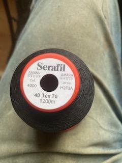

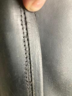

Members TomE Posted October 13 Members Report Posted October 13 @Mulesaw Wanted to thank you again for this tutorial, Jonas. Followed your method for installing the zipper and it went smoothly with a nice neat result. I am using V92 thread with 2 stitch lines along each side of the zipper. My patcher has trouble accommodating the thickness of the heel so I switched machines and used V138 thread to sew across the bottom of the zipper. I need more practice sewing straight lines with the patcher, especially when sewing the far/back side of the zipper that is harder to see. However, things are going in the right direction. Quote
Members Mulesaw Posted October 18 Author Members Report Posted October 18 On 10/13/2025 at 2:39 AM, TomE said: @Mulesaw Wanted to thank you again for this tutorial, Jonas. Followed your method for installing the zipper and it went smoothly with a nice neat result. I am using V92 thread with 2 stitch lines along each side of the zipper. My patcher has trouble accommodating the thickness of the heel so I switched machines and used V138 thread to sew across the bottom of the zipper. I need more practice sewing straight lines with the patcher, especially when sewing the far/back side of the zipper that is harder to see. However, things are going in the right direction. Glad to hear that it is helpful 🙂 The heel part is difficult, I think the most challenging boots are those where the small flap is very close to the heel, it is difficult to get the patcher close enough, and it is easy to break a needle then. I always make sure to remove any inlay soles, as that can give just a fraction of an inch more room. Sewing straight is a challenge, and it doesn't help when the inner lining suddenly rides on the edge of the needle plate, that is enough to shift the stitch line 1/16", To avoid that, I try to sew my straight lines while holding the boot (and adjusting the patcher) to maybe 20-30 degrees to your right. (If sewing straight away from you is 12 o'clock, then sewing at 4:30 - 5 o'clock) can help so that the inner lining doesn't suddenly go down the side of the needle plate. Brgds Jonas Quote
Members TomE Posted Thursday at 02:17 AM Members Report Posted Thursday at 02:17 AM On 10/18/2025 at 2:00 AM, Mulesaw said: Glad to hear that it is helpful 🙂 The heel part is difficult, I think the most challenging boots are those where the small flap is very close to the heel, it is difficult to get the patcher close enough, and it is easy to break a needle then. I always make sure to remove any inlay soles, as that can give just a fraction of an inch more room. Sewing straight is a challenge, and it doesn't help when the inner lining suddenly rides on the edge of the needle plate, that is enough to shift the stitch line 1/16", To avoid that, I try to sew my straight lines while holding the boot (and adjusting the patcher) to maybe 20-30 degrees to your right. (If sewing straight away from you is 12 o'clock, then sewing at 4:30 - 5 o'clock) can help so that the inner lining doesn't suddenly go down the side of the needle plate. Brgds Jonas This YKK Zippers 101 document has some useful information and styles I hadn't seen before. 0001.pdf Quote
