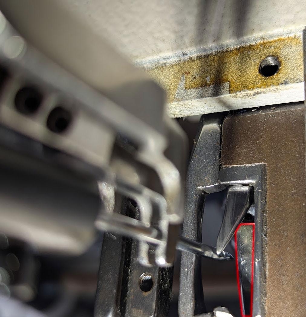

@AlZilla It's in the post below the one you mention that I am wondering if it's bent or not (post is still visible on previous page).
I cheched it and can not decide if it's bent or not... It's hard to tell when you have nothing to compare to so I ordered a new one but won't get it before two weeks
Meanwhile, I put a 230/26 needle in the machine (I normally use 160/23), as asked in engineer's manual and needle was rubbing on the shuttle point so I set "needle to shuttle clearance" accordingly, it's not rubbing anymore
I am now trying to set up "needle to shuttle driver clearance" but I am confused trying to understand what I have to look at. Is it the part of the shuttle circled in red in my pic ?

You can move the feed dog holder a bit sideways.The feed dog holder is attached to the feeding rod with 2 pointed screws (one on either side).
When I look at this picture I think the feed dog seems to be misaligned. What I would do first is loosen the 2 feed dog screws and try to align the feed dog.
Then I would try to move the feed dog holder to the left.
It should be the same as on Singer or 45K or Adler 104 flat bed machines.
I´ll take pictures tomorrow...
I read through that section and wasn't sure, either.  I'll bet Friquant or Constabulary will know.  I saw the post that seems to show a little back and forth movement for the feed dog. Maybe that will help get you in the ballpark.
If I'm visualizing it right, it seems like moving the needle away from the hook would move it even closer to the feed dog hole.
It'll be interesting to see the final outcome.

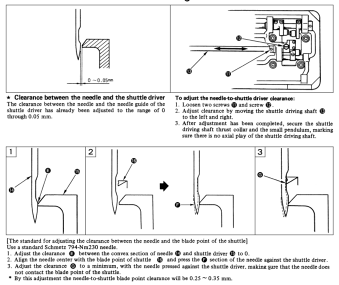

An internet search for juki 243 parts manual led to this: https://www.jukisewingmachines.co.uk/pub/media/productfileupload/j/u/juki_tnu243_parts_book.pdf
On pages 11 and 12 shows the hook driving shaft (part #10), the left end of which is the shuttle driver.

15 hours ago, Damas said:
Actually I just noticed feed dog seems to be bent on that pic...
I haven't found many parts on a sewing machine that bend. That is, most parts on my sewing machines seem to be a very hard material that is likely to have fracture as its failure mechanism, not plastic deformation.
friquant. Like a frequent, piquant flyer.
Check out my blog: Choosing a Motor for your Industrial Sewing Machine
I popped the end off my 441 clone and it's pretty easy to see which part is pushing the shuttle just by jiggling the hand wheel. The diagrams above make it look like an easy adjustment.
