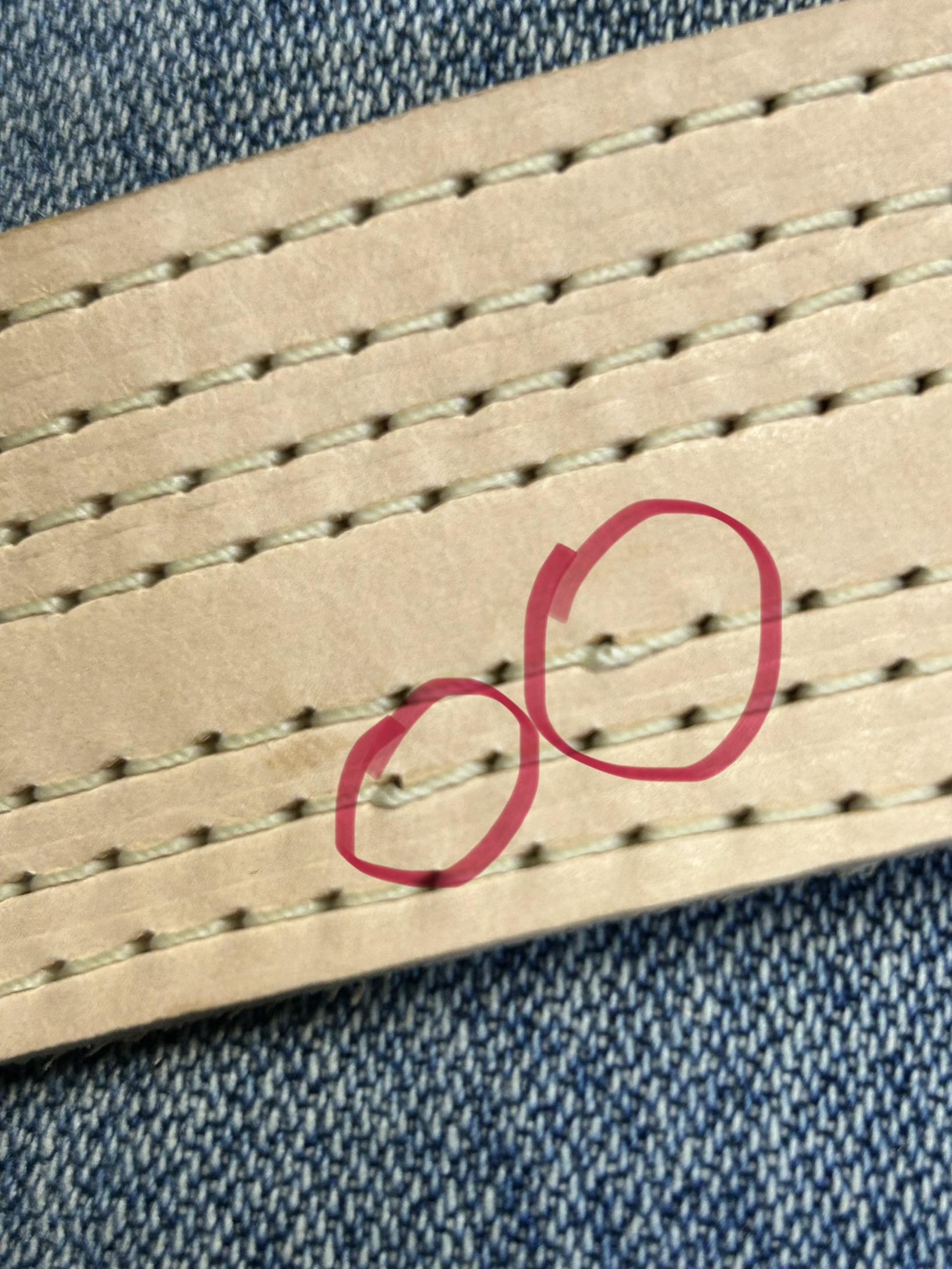

Members Alienleather Posted November 26, 2025 Members Report Posted November 26, 2025 When sewing with cobra class 26 I have this random lose threads ! Any tips in how to fix it? Quote
Members DieselTech Posted November 27, 2025 Members Report Posted November 27, 2025 I am going say, user error. You probably moved the piece when sewing or it slipped a bit while sewing. I am no means a professional & I've only used my class 26 maybe 6hours total. Maybe some more experienced pros will chime in. Quote
Moderator Wizcrafts Posted November 27, 2025 Moderator Report Posted November 27, 2025 Sometimes, it's the way the thread comes off the spool. SOme thread is twisty. Some is bonded too much or too little, some windings may have crossed over or under other windings, some windings fall down and get caught under the spool. I've had knots suddenly appear on top after laying perfectly in the center. Sometimes, I discover that the top thread has twisted itself around the thread stand and is jammed tight. Even the bobbin thread can jump out of its position under the tension spring. Or, it could get caught under the bobbin. Quote Posted IMHO, by Wiz My current crop of sewing machines: Cowboy CB4500, Singer 107w3, Singer 139w109, Singer 168G101, Singer 29k71, Singer 31-15, Singer 111w103, Singer 211G156, Adler 30-7 on power stand, Fortuna power skiver and a Pfaff 4 thread 2 needle serger.
Members Constabulary Posted November 27, 2025 Members Report Posted November 27, 2025 check if thread keeps hanging on the bobbin case opener Quote ~ Keep "OLD CAST IRON" alive - it´s worth it ~ Machines in use: - Singer 111G156 - Singer 307G2 - Singer 29K71 - Singer 212G141 - Singer 45D91 - Singer 132K6 - Singer 108W20 - Singer 51WSV2 - Singer 143W2
