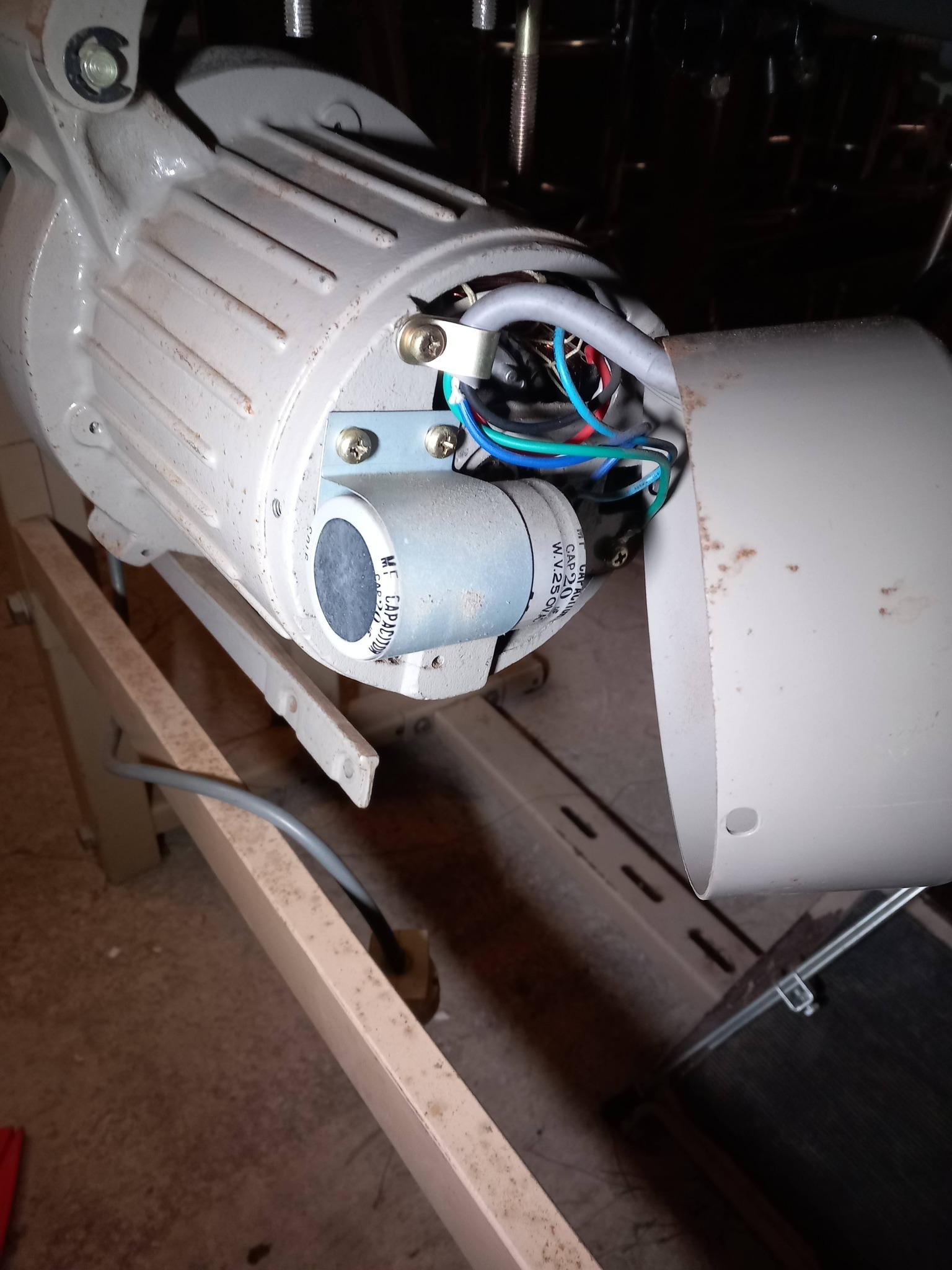

this is how she was listed with a picture of the motor and a picture of a few bobbins so not much info but enough for me to see it was in the 145/545 family

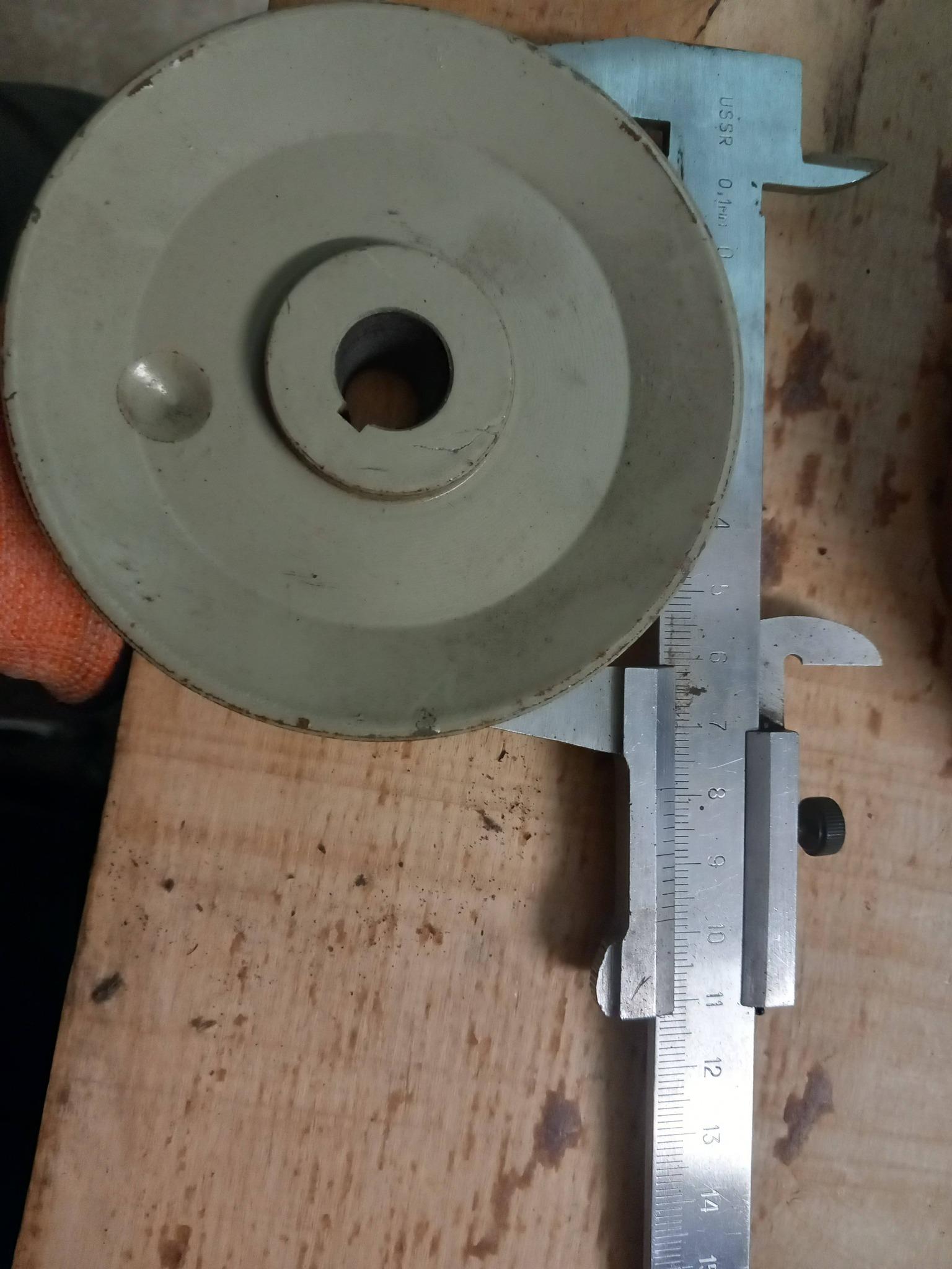

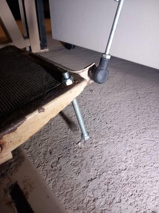

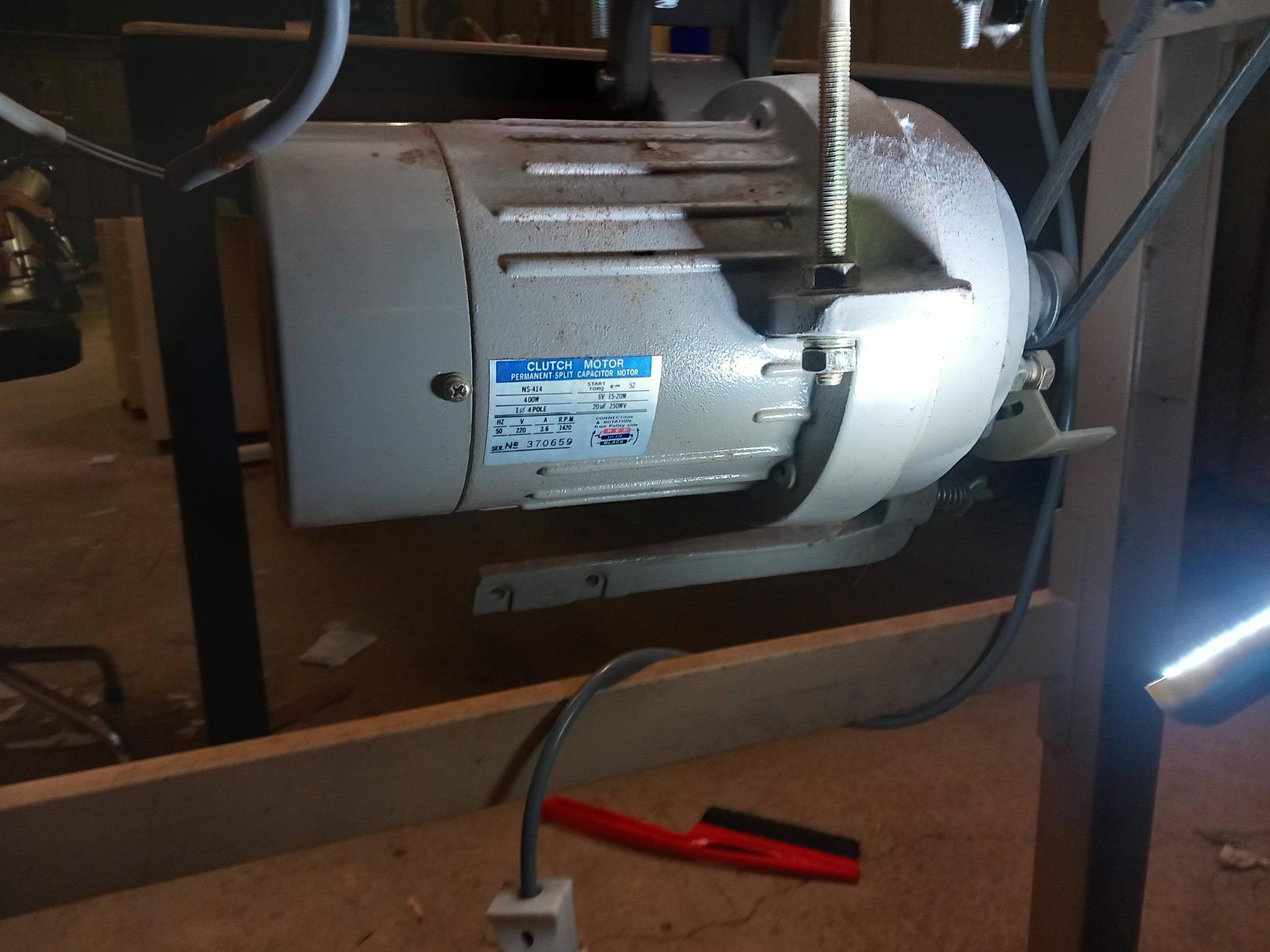

put the head in a padded plastic crate. and the table with motor beside it. straped it down and went on my way.606357265_4447139665514723_8140134593811331363_n.jpg.7e32cefcb7106d688f1cacd83b1e82cf.jpg605135569_4447139135514776_5424799219529392933_n.jpg.7b6316f7c47ee347700678a2ded23bbc.jpg605145912_4447139358848087_1374406227762588201_n.jpg.02416168afdbfc31212b9be2a101681f.jpg605637494_4447139802181376_4026352909520716536_n.jpg.13f40d704931165d66b891bdcf7ea0fa.jpg607816876_4447139228848100_5291083369976703723_n.jpg.f5c9015f5dde3352324e371579112f36.jpg608790771_4447139058848117_8954330894769908360_n.jpg.73fe0a93ca2f0b7dd6246f6bd108d006.jpg606461344_4447140095514680_2271847890177702143_n.jpg.b1fd296183e958b7ef643cc644d6ec8c.jpg
i got back to my storage unit and set it up. i didnt have time and no power yet so could not test it. but rather clean it first anyway.
as you can see its a pfaff 545-H3-6/01 CSMN not the best or high optioned for my kind of work but pretty decent
