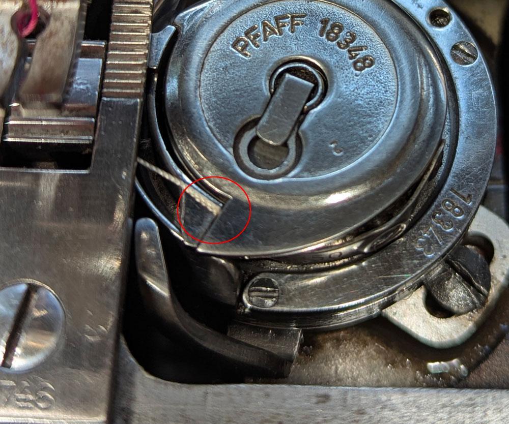

And I am experiencing an issue with tension :
There isn't any notch neither in bobbin case top, neither in bobbin case base as it normally should (circled in red below, sorry blurry pic).
As a consequence, thread is pinched hard while sewing, and pulling the needle thread to the bottom of my work, no matter how I try to set upper tension or bobbin tension.
Have any of you having this machine, a similar problem and how did you deal with it ?

Is it maybe supposed to come out over to the right, at the 5:00 position and ride over that tab?

There were rougly 10 different hooks for the 545, depending on thread thickness etc.
Your hook/machine is set up for very thin thread (likely textile garment production), so no open notch. Likely max. NM 100 thread.
Good thing: You could still get parts and adjust the 545. What thread are you intending to use?
Thread underneath the base(on the left) instead on going between it.
I believe not, according to user manual, but I can be wrong
That makes sens. I intend to use 20 (tex 135) top and 30 (tex 90) bobbin, with a 120 needle. I suppose I'll have to get a new bobbin case for it...
I'll give that a try !
