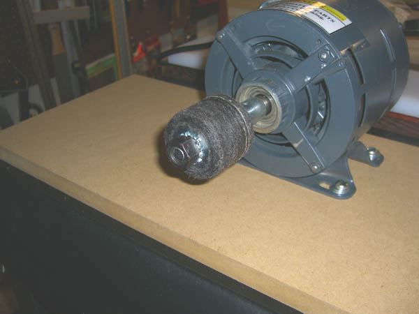

Edges - Burnished with wax and mechanical burnisher, Fiebings Edge Kote
