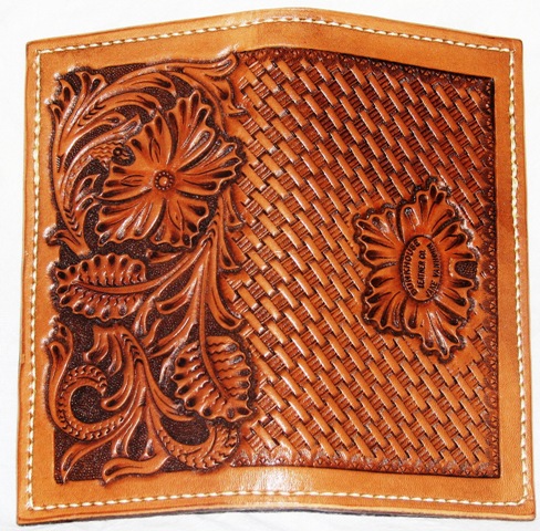

Hello, I'm kinda new here but how I do it is scribe my border line, basket stamp up to it, take my modeling spoon and gently wipe out any places that I have went over the border with the BW tool, cut the border line, bevel, then run my border tool of choice around it. By doing it this way it kind of seems to set the basket weave in a little. I thought I would post a pic kind of the way I do it. Hope that helps.
Jake
