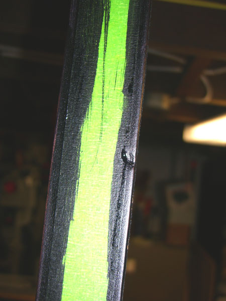

Bree Posted January 22, 2009 Report Posted January 22, 2009 I wanted to try a new product I ran into in one of my woodworking magazines. It is called FROG Tape. It is a fairly tacky masking tape similar to blue tape. But it has a twist that is significant for working leather. The edges of FROG tape are coated with an expanding absorbant. It is designed to seal the edge against water-based paint running under the tape. Leather is not a smooth surface. It has hills and valleys when looked at very closeup. So a product that can expand to block any wicking of dye under some masking tape interested me very much. If it works it can assure me of razor sharp perfect edges on a belt with little or no risk of the black dye ruining a natural colored blank. I ordered some FROG Tape and it arrived today. So I took a piece of strap about 1 1/4" or so and ran a piece of 1" FROG Tape up the middle of the blank taking care to create a nice straight line parallel to the edge. I gave it a quick run thru the burnisher. Then I took some water-based Fiebings Edge Kote and with a foam brush just schlepped it on the blank... both edges. I noted that there was a depression in the leather at one point and the FROG Tape could not make a perfect bond with it. If it was going to fail, this would be the place. I let it dry for a few hours and then peeled the FROG Tape off and took a good look at the results. Judge for yourselves. The FROG Tape did a fabulous job. I am thrilled with its performance. I am giving away a secret even before it has become a secret! Check it out. Pretty darn good edge line if you ask me... a lot better than I can put on with either a brush or piece of felt. Quote Ride Safe! Bree 2003 Dyna Wide Glide Memberships: Iron Butt Association, Niagara Falls HOG, Wild Fire HOG NRA, Niagara County Sportsman's Association

Bree Posted January 22, 2009 Author Report Posted January 22, 2009 (edited) FROG Tape is expensive... like about double the cost of Blue tape. I got mine at Amazon.com. My thought was to take the 1" tape and split it putting one half on the top of the blank and one half on the bottom You must be careful to make sure that the outer edge of the tape is aligned to the belt edge. If you split the tape, the inner edges of the split tape don't have the expanding stuff... only the outer edges. So be careful. It is a fairly strong tack tape. Best to remove it fairly soon after applying it. I removed mine easily and it left no residue. But go slow or you might tear it as you remove it. I plan to have only a small area of the FROG Tape in actual contact with the leather. I will fold the inner area back on itself so I can just lift it off. I won't be freestyling the dye like I did on the experiment. All that I need is 1/4 of an inch to catch any mistakes and give me a nice straight line. Edit: Max... I will airbrush some water-based sealer on the test strap and see if there are any issues. A perfectly straight line is much easier to screw up than one that isn't!! Any flaw is immediately evident. Edited January 22, 2009 by Bree Quote Ride Safe! Bree 2003 Dyna Wide Glide Memberships: Iron Butt Association, Niagara Falls HOG, Wild Fire HOG NRA, Niagara County Sportsman's Association

Bree Posted January 23, 2009 Author Report Posted January 23, 2009 I airbrushed a full airbrush cup of Super Sheen onto the strap both sides and the edges. Here is the result. Sorry for the yellow tint... bad light. Complete seal with zero run after 3 sprays. I tried to put some water on the edge to make it run... no run... no bleeding of color onto my finger. Test successful. Quote Ride Safe! Bree 2003 Dyna Wide Glide Memberships: Iron Butt Association, Niagara Falls HOG, Wild Fire HOG NRA, Niagara County Sportsman's Association
Members JustWakinUp Posted January 23, 2009 Members Report Posted January 23, 2009 One quick question. Is the tape applied to the flesh side? Have you tried applying it to both sides? I know when putting blue tape on the good side it tends to muff it a bit. Quote

Bree Posted January 23, 2009 Author Report Posted January 23, 2009 (edited) One quick question.Is the tape applied to the flesh side? Have you tried applying it to both sides? I know when putting blue tape on the good side it tends to muff it a bit. No It was not applied to the flesh side. The reason was that I am making double layer belts so the flesh side gets glued. If I was applying it to the flesh side, I would skive the blank to get a nice smooth surface and apply the tape. OR I would size or paste the flesh side so there is a smoother surface for the tape to adhere to. I would not feel real confident if the flesh side were fuzzy but I haven't tried it so I am only offering a speculation. Edited January 23, 2009 by Bree Quote Ride Safe! Bree 2003 Dyna Wide Glide Memberships: Iron Butt Association, Niagara Falls HOG, Wild Fire HOG NRA, Niagara County Sportsman's Association
