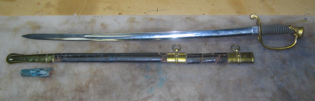

Contributing Member UKRay Posted January 27, 2009 Contributing Member Report Posted January 27, 2009 This past few weeks I have had a few sword scabbards in for restoration. In the main this is complex, time consuming and technically challenging work - which, to be honest, is just how I like it as every one presents its own set of problems and I never get bored working out how to do the jobs. I have now hit a problem that I've never come across before as I need to completely reconstruct a thin leather scabbard (2mm thick leather) for a sword that is almost three feet long. The original (rotten and crumbling) leather looks and feels like veg tan but it is considerably stiffer in texture - in other words the original finished scabbard must have been very rigid - almost solid to the touch. Does anyone know anything about the way scabbard leather might have been treated to make it stiff and hard to the touch? I wondered if it had been painted with shellac? The original surface of the leather I have removed is still fairly rigid even now - both inside and outside - more than 200 years after it was made.. I have tried to reproduce this using all kinds of treatments including neat-lac and a number of similar products but it doesn't feel the same. Remember we are talking about a tube of leather that is three foot long and no more than 3/4" wide so there isn't much room to get in there with a paintbrush. Do you think they painted the inside first and then stitched it up afterwards? Remember that this is a butt jointed job and the stitches have to be buried inside the leather otherwise the sword would chafe through them. It is possibly worth noting that it takes me about two or three hours to hand-stitch one of these things so whatever was painted on would need to remain 'liquid' for that time and cope with the seam being hammered flat and the tube shaped to fit neatly around the sword blade without sticking to the costly and highly decorated and blued metalwork. In addition because the scabbard was part of a uniform it would have had a very presentable finish - so coating with something like tar isn't an option - or is it? Does anyone know how this might have been done? Anyone got any thoughts? It is a fascinating puzzle. Quote "Some mornings, it's just not worth chewing through the leather straps" Ray Hatley www.barefootleather.co.uk
Members badger Posted January 27, 2009 Members Report Posted January 27, 2009 (edited) Hi Ray, Interesting job, sure enough. I suspect the still-soft stitched scabbard has been placed on a slim former (possibly the sword itself wrapped in greased paper)while the outside was finished. Then the goop, whatever it is, tipped in and swilled about then tipped out and the scabbard left to drip. I'm not saying this is the way it was done, just how I would approach it. Many old glues, based in fish and mammal (horse and cow) proteins, cross-link and form a rigid film after they dry in air. Fish glue goes very stiff and solid. Have you seen a dried fish? like a rock. After the fish glue hardens it can be varnished to protect it from moisture. Dunno............ Cheers, Karl Edited January 27, 2009 by badger Quote

Members scottishshoemaker Posted January 27, 2009 Members Report Posted January 27, 2009 Ray I have done one qiute recently . Took a piece of 3mm oak bark shoulder, soaked in a bath over night, placed round sword hand stitched then boned for all my life. Boneing squeezes out excess leather and give the leather its strength and shine, if you want a dark colour don't use oxalic acid, if you want it lighter use acid. You can always use atest piece to see what colour you get when finished. Hope it helps. Sorry also used a piece of orthoside to protect sword from water. Quote You Want It, I'll Make It!
Contributing Member UKRay Posted January 27, 2009 Author Contributing Member Report Posted January 27, 2009 Apologies if this thread is turning into a 'stream of conciousness' thing, but I often find it easier to think things through by writing them down... I think boiling water had something to do with the process but I am confident it is not 'old school' cuir bouilli for a number of reasons, the main one being that the original leather almost certainly wasn't boiled and then 'formed' it was simply cut out, stitched and hammered flat then trimmed to fit the metal mounts. I'm not saying the thing wasn't dunked in boiling water to harden it after it was made but that would have been quite an undertaking for a single scabbard when all water was heated over wood fires. My guess is that if boiling water had been used it was poured over and through the scabbard and the sword inserted as a former - now that is definitely possible. Things against cuir bouilli also include the nature of leather 200+ years ago. We have all experienced that modern leather stretches in very strange and unpredictable ways sometimes - how much worse would it have been all those years ago. How could you gauge how much wet leather would stretch or shrink? Remember also that this leather was pretty consistent in thickness and the stitching was superb which suggests that the guy who made the scabbard was a better than average craftsperson. I can't see them dunking a valuable job in boiling water and taking a chance on it turning out okay. Here is a quick refresher on modern cuir bouilli thinking courtesy of Wikipedia: Basically Cuir Bouilli is a means of making hardened and stiffened leather. Although there is some disagreement among some leatherworkers as to how this is accomplished, there is a significant amount of evidence to think that it was done by molding wet vegetable tanned leather. This leather can be formed into any number of forms, which, on drying, will retain that shape. The wet leather can be set more firmly by drying it under moderate heat, the degree of rigidity obtained being determined by the drying temperature. A faster method, which produces extremely hard and rigid shapes, is to dip the molded leather into boiling water for anywhere from 20 to 120 seconds. This technique causes the partial melting of the fixed tannin aggregates in the leather, making them plastic, causing them to flow and redistribute themselves throughout the fiber network of the leather. On cooling, the fibers become embedded in what can best be called a tough, three-dimensional, polymer network or resin, somewhat similar to the materials made by condensing formaldehyde with substances such as phenol, urea or melamine. Now that sounds distinctly possible so thanks for the clue, Tasha. I still think there is more to this though... The idea that the leather could have boned to a hard finish is interesting and definitely possible but the texture and shape of the surviving bits suggest it was simply cut to size very acurately and then stitched and hammered. There is no smoothing that I would associate with boned leather - Now I could very easily be wrong, scottishshoemaker - but somehow... The next question is how would the scabbard have been finished to retain this hard shell. I have just realised that I haven't told you what sort of sword it is - the sword is almost a twin to the one I posted a week or so ago. A Royal Navy sword that would have been carried by an officer. Not a hacking tool like a cutlass but something a lot more expensive and much lighter. The leather would have been very good quality to survive a life at sea. The metal fittings, the throat and the suspension loop that slung the scabbard from a belt or baldrick - sorry I don't know the technical term for this specific bit of kit - are tight fitting but do not look 'made to measure' therefore this scabbard was almost certainly one of many. Was it mass produced? How did it survive this long? This is where I think Karl's old fish/bone glue comes into play - but is a clear fish glue waterproof? You mention varnish Karl, but was this around 200 years ago so would they have used something like shellac? Remember this was for a Naval officer who couldn't afford an attack of the droops on parade. Ships of the Line (think HMS Victory - http://www.history.uk.com/articles/index.php?archive=50) are nasty damp things that are almost as wet inside as out. Anyone got any more ideas? Thanks for the suggestion of the V&A, Vikti, for anyone who hasn't been there it is an absolute treasure trove of wonderful leathery things. I try to visit every time I'm in London but don't have any contacts in the conservation department. I'll rectify that the first chance I get. Dwight, you have hit on the right method but, I fear not the solution! The wax idea was a good one for at least an hour - but it didn't make the cut... Now mock ups are a different story - I have already made several mock ups - my workroom is littered with 'em - and will make several more to get this right. But you know what they say about a trouble shared? LOL Quote "Some mornings, it's just not worth chewing through the leather straps" Ray Hatley www.barefootleather.co.uk
Members ChuckBurrows Posted January 27, 2009 Members Report Posted January 27, 2009 Ray - I'll add more later but a few things........ 1) First clear you're mind of the mis-conception ( a widely held one) that folks 200 years ago were not technical - large scale factories of all types including weapons factories were in place as early as the middle ages. Water power and later steam power (mid-1700's) were in use. Take a look at some of the old engravings/woodcuts and you can see how technology was used. 2) re: cuir bouilli - http://www.personal.utulsa.edu/~Marc-Carlson/leather/hl.html one of the best examinations on line - note that boiling is not necessarily needed or wished for - leather polymerizes (basically turns into a form of hide glue) at around 160° F - the article gives more specific info - once hard PROPERLY made cuir bouilli is virtually unable to be softened since as noted it polymerizes and is this changed at the molecular level 3) re varnish: yes they had varnish it goes a long ways back - there were two types, linseed oil based and spirit based - for more see the history of violin varnishes 4) I have both repaired originals and made several period sheaths and will explain more later - got things going in the shop right now - basic procedure was to sew while cased over a form (no pounding flat) , dry at the proper heat to harden, finish, apply fittings......... hope this helps........ Quote Wild Rose Trading Company Two roads diverged in a wood, and I, I took the one less traveled by, And that has made all the difference.
