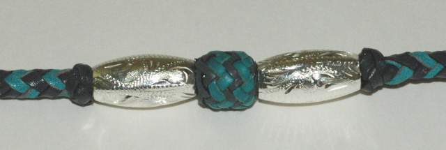

Members Stringman Posted March 11, 2009 Members Report Posted March 11, 2009 On the dog leads that you see with the beads, are the beads just slipped on and then secured by stopper knots? I've attached an example. Quote
Members rawhide1 Posted March 11, 2009 Members Report Posted March 11, 2009 Stringman That's how I would do it. Mike Quote
ArtS Posted March 12, 2009 Report Posted March 12, 2009 Where do you get silver ferrules like this? Thanks, Art Stringman said: On the dog leads that you see with the beads, are the beads just slipped on and then secured by stopper knots? I've attached an example. Quote

Members roo4u Posted September 17, 2010 Members Report Posted September 17, 2010 there is a tutorial pinned in braiding on turksheads...in the example shown at the beginning of this topic the center knot is a pineapple knot, which is a turkshead with an interweave, done over a bead to give it size and shape. then the two knots that are on either end are simple spanish ring knots. ring knots are very easy to do, hardest thing is not breaking the lace when you tighten them . then you simply use smooth jawed pliers to make them flat and push them up against the bead. Quote
