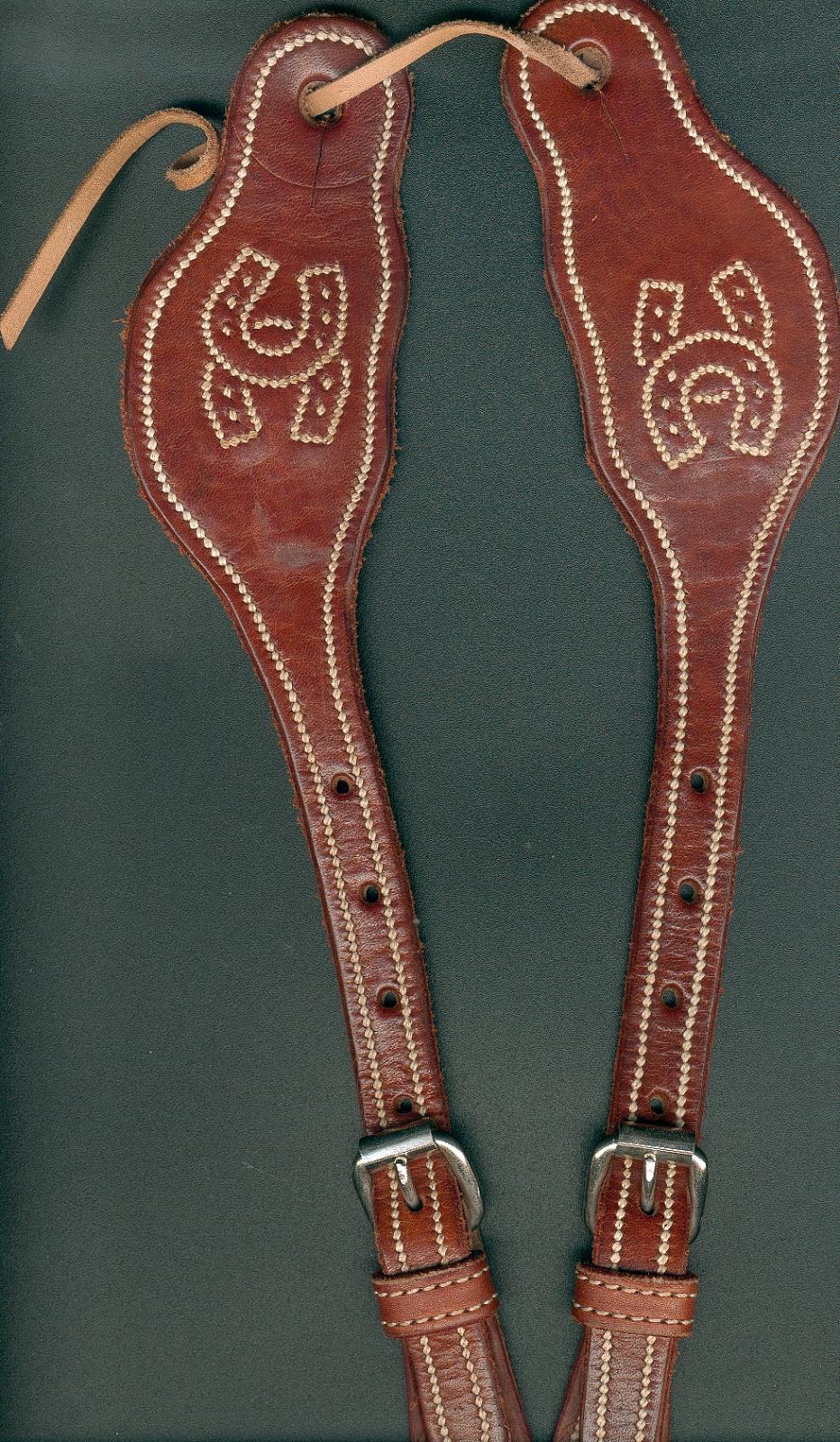

I hand-embroidered a pegasus on a leather back pack that I made. I used a glover's needle and regular embroidery thread... it's pretty hammered now, I used that back pack for a purse and hauled it absolutely everywhere for years and years. I don't think it's worth looking at anymore but if you want to see it I guess I could photograph it. The leather is deer skin.
I've also hand-beaded leather. I did a headstall and reins for one of my horses. Again, I used one of those glover's needles that has a tip with three faces sharpened on it. In this case the leather was regular English bridle leather. This is still in excellent shape and I use it when I ride my horse Tito. It's lasted about 15 years so far.
It can be done!

Some simple embroidery I did on a pouch when I was a SCAdian many, many years ago.....
The Mexicans do real fancy leather embroidery using a type of bromelaid thread - IIRC it's called pitiado.....
On most commercail leather you shouldn't get your stitches too close = on alum tawed or brain tanned they can get very close....
