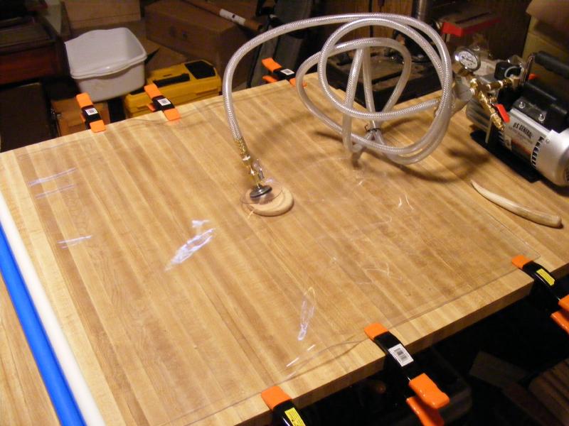

Denster Posted March 31, 2009 Author Report Posted March 31, 2009 K-Man : Kere are the pictures that show the detail that is brought up by the full vacuum. These just came out of the bag all I did while they were in was run my thumb along the slide frame line. Larry: I ordered the bag on line. The site is on my other computer I'll post you a link later. Yes the holster is sewen and wet prior to placing it in the bag. Careful with the retirement idea. That was my intention make a few holsters get a little extra fun money and take a big deduction on my taxes for a home business. Worked fine for the first year. Now I work harder than I did when I was working and I'm going to have to be really creative to keep from paying taxes. Quote

Denster Posted March 31, 2009 Author Report Posted March 31, 2009 Larry: Here is a link to where I purchased the vacuum bag. I also purchased the continuous run parts kit from them. Not absolutely necessasary but very handy. http://www.veneersupplies.com/product_info...roducts_id=2321 By the way I don't believe the shop vac will produce enough power for the job. You can get a 2.5cfm vacuum pump from Harbor Freight for about $80 or less when on sale. More than enough oopmh. Quote

Members jbird Posted March 31, 2009 Members Report Posted March 31, 2009 Yes if you can a closer picture of the vacum unit thing your using and how it works the attachment your using and just some more detailed pics. Thanks a bunch Josh Quote
Denster Posted March 31, 2009 Author Report Posted March 31, 2009 No problem Josh. I'll get some more picks in the morning. Quote

Denster Posted April 2, 2009 Author Report Posted April 2, 2009 Boomstick: Thanks a bunch for the pics. I appreciate you're going to the trouble to do that. Josh : Here are the pics you asked for. As you can see I clamb the sides of the bag to the table. One of the tricks I learned as it keeps the bag from bunching up and it pulls straight down. All of those fancy attachments on the side of the pump are the accessory kit I bought from that site I posted. Basically it is just a filter guage and vacuum adjustment for how much vacuum you want to pull. That wood disc is the platnen I mentioned. It is grooved all the way around to keep a seal from being made around the air outlet before a sufficeint vacuum in the bag has been established. The white rod is rolled onto the end of the bag and the blue cover snapped over it to seal the bag. Quote
