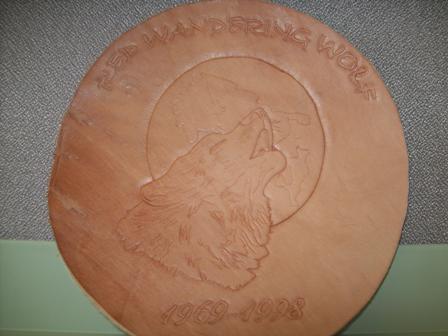

Members flyingcuda Posted April 1, 2009 Members Report Posted April 1, 2009 start to finish..how would you proceed, i can't do the swivel knife yet...too scarry i will be doing it on a round piece of leather. i don't have antique..thought i did..but i do have hi liter. thought about trying the white in the cloudy parts..but have not had any luck with white. i also have leather glow. this is going to be an important and sentimental piece for me. i thought if i could get some expert's thoughts..it may save me some heart break. thanks! Quote

Members flyingcuda Posted April 1, 2009 Author Members Report Posted April 1, 2009 unfortunatly...i did already get it transfered into the leather....good to know about transfering it into sketch..would have been easier to do. now i am trying figure out what i want to do next...should i dye..if so what coulours...or just rub the hi lite into it...and how to deal with the moon. thank you for the sketch idea, much appreciated! Quote
Members flyingcuda Posted April 1, 2009 Author Members Report Posted April 1, 2009 pic of what i have done so far..any suggestions on what would look good to finish this off with will be greatly appreciated..thank you. Quote

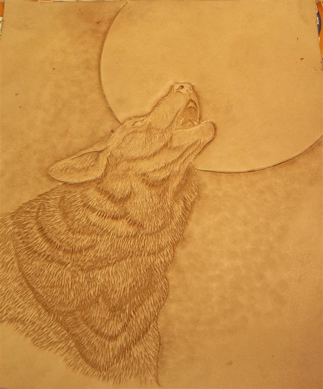

Contributing Member ClayB Posted April 1, 2009 Contributing Member Report Posted April 1, 2009 I did a very similar pattern to this one for one of our carving challenges here on LW back in September. There are a lot of ways to add hair to a project like this. I took a couple pictures as I was working on this project, maybe they can give you some ideas. There were very few tools used, but I did cut the outline with a swivel knife. It looks like you did fine without it. I did some beveling on the face to put in some of the features, and then cleaned them up with a modeling tool. Then I used a pear shader to put some muscliing on the body. All the hair texture was done with a narrow pointed figure beveler. I just tapped the impressions very close together, and made sure to try and follow the natural flow of the hair, making layer after layer of hair. I haven't finished mine up yet. I'd like to put some texture in the moon, and then color it someday. Quote
