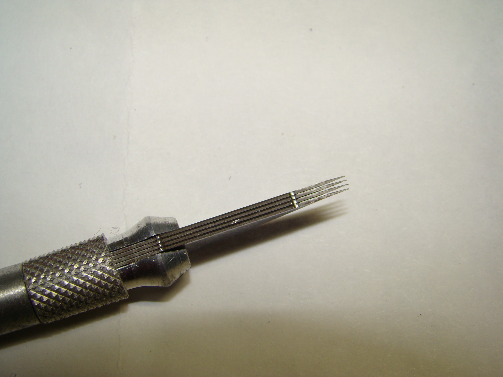

Members hiloboy Posted May 5, 2009 Members Report Posted May 5, 2009 (edited) Rick, heres one i madeout of a old xacto knife and some #11 blades. i tryed more blades but i find i have more control on smaller stuff with less blades.. Edited May 5, 2009 by hiloboy Quote Aloha, Curt http://www.picturetrail.com/linecutter

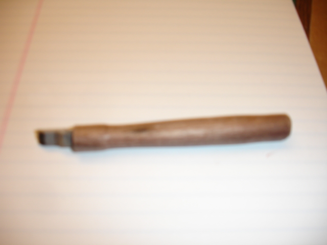

Members MHolzer Posted May 7, 2009 Members Report Posted May 7, 2009 Here is the one my dad (whinewine) made. sorry it took so long for me to post pics. Quote 1. A robot may not injure a human being or, through inaction, allow a human being to come to harm. 2. A robot must obey orders given to it by human beings, except where such orders would conflict with the First Law. 3. A robot must protect its own existence as long as such protection does not conflict with the First or Second Law.

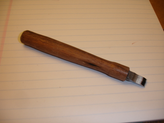

Members rickmc Posted May 10, 2009 Author Members Report Posted May 10, 2009 (edited) Instead of doing leather last night (like I should have), I made one out of a piece of tack hammer handle that I had lying around. I epoxied 7 #11 Xacto blades together & inset them into the handle. The hardest part was getting the tips lined up & even while the epoxy dried. thanks for all your help, whinewine, I really appreciate your suggestions and know that you sacrificed precious time to help, as all of you have. I tried this and here is my first attempt, I took a piece of black walnut, turned it on my lathe and drilled the hole in the end, unfortunately, I did not have the right bit, so it took 15 blades to fill in the hole that I made, I used exacto #16 blades. I used JB Weld to hold them in, and yes it was difficult to have all of the align perfectly. I actually used a pencil underneath the curve on the blade to align them and held the handle down with a small c-clap until it dried. Please tell me what you think. Edited May 10, 2009 by rickmc Quote
Members rickmc Posted May 10, 2009 Author Members Report Posted May 10, 2009 Rick, heres one i madeout of a old xacto knife and some #11 blades. i tryed more blades but i find i have more control on smaller stuff with less blades.. Hiloboy, did you have to modify the handle or could it hold the 4 blades? Rickmc Quote
Members hiloboy Posted May 10, 2009 Members Report Posted May 10, 2009 Hiloboy, did you have to modify the handle or could it hold the 4 blades? Rickmc Rick, i had to cut the ring that tightens the blades in half.. then i filed the part that holds the blades. i have one handle that will hold 6 to 8 blades ..i don't use it that much i work on a lot more smaller stuff.the thing you would have to do is cut the ring smaller the more blades you use.. the good thing is when you need to change blades its like changing one blade.. put in how many you want and tighten the handle down... no gluing blades together.. this is just what i do.. i like some of the other ideas i see here to..and they look a lot more pretty than what i use.. but what ever work for you.. Quote Aloha, Curt http://www.picturetrail.com/linecutter
Members whinewine Posted May 10, 2009 Members Report Posted May 10, 2009 thanks for all your help, whinewine, I really appreciate your suggestions and know that you sacrificed precious time to help, as all of you have. I tried this and here is my first attempt, I took a piece of black walnut, turned it on my lathe and drilled the hole in the end, unfortunately, I did not have the right bit, so it took 15 blades to fill in the hole that I made, I used exacto #16 blades. I used JB Weld to hold them in, and yes it was difficult to have all of the align perfectly. I actually used a pencil underneath the curve on the blade to align them and held the handle down with a small c-clap until it dried. Please tell me what you think. Rick: It looks very nice. Good job! I like it. (At some point, I'd like to get a small lathe for myself, but I just can't justify one at this time.) Quote

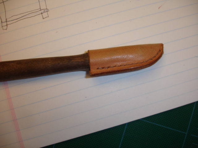

Members rickmc Posted May 10, 2009 Author Members Report Posted May 10, 2009 so I guess the answer is to make a sheath of sorts to protect the tips (makes sense, also- you don't want this thing rolling around loose somewhere where it could hurt you more than you can hurt it.).russ If you need to replace it, I guess you make another, or you force-fit into the handle rather than use epoxy to mount the blade pack. Here is the sheath that I am using, and oh by the way, FORCE FIT IS NOT A GOOD IDEA LOOK AT THE SECOND PICTURE Quote
