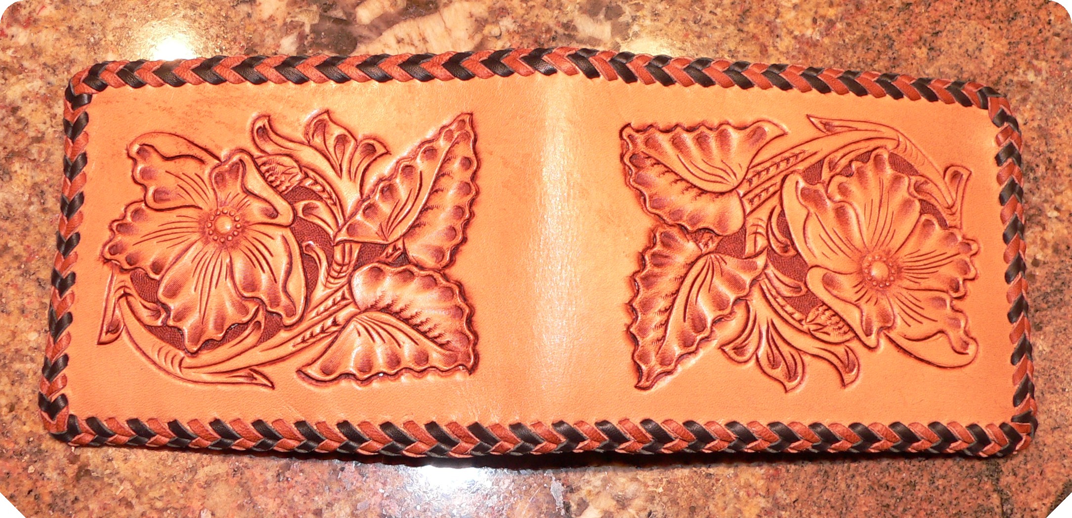

Members SouthPaw Posted July 15, 2009 Members Report Posted July 15, 2009 Here is a new check book cover i just finished. Comments welcome. Quote SouthPawArt.com Southpaw Art - Etsy
Members wildrose Posted July 15, 2009 Members Report Posted July 15, 2009 Very nice! I've been wanting to do daffodils myself. I like your use of color. Quote Holly Moore Wild Rose Creations http://www.wrcleather.com
Members Tina Posted July 16, 2009 Members Report Posted July 16, 2009 Nice work on those Daffodiles:-) I really like the lacing too, very even and nice Quote "He who works with his hands is a laborer. He who works with his hands, and his head is a craftsman. He who works with his hands, and his head, and his heart, is An Artist" http://vildkorpens-laderlya.deviantart.com http://tupali.deviantart.com/
Members SouthPaw Posted July 16, 2009 Author Members Report Posted July 16, 2009 Thank you for the comments. wildrose : there from the tony laier craftaid pack tina : i still have to learn how to end the lacing better. Quote SouthPawArt.com Southpaw Art - Etsy
electrathon Posted July 16, 2009 Report Posted July 16, 2009 (edited) You asked for comments, here is a lacing critique if you want it: Your holes are too big, too far in and too far apart. Slots look more profesional than holes, they fit the lace. Use round holes for round lace, flat holes for flat lace. When the holes are closer togeather the lacing looks "fuller" and more continuous. You already know about the flaw closing the ends togeather. Just watch the steps in the directions. It always seems like you are doing it wrong till you pull it tight, and it looks perfect. I like the flowers. Edited July 16, 2009 by electrathon Quote
Members SouthPaw Posted July 16, 2009 Author Members Report Posted July 16, 2009 thanks carvedon. thanks electrathon ...i will get a chisel for the slots and do a few practice runs with it. Quote SouthPawArt.com Southpaw Art - Etsy
