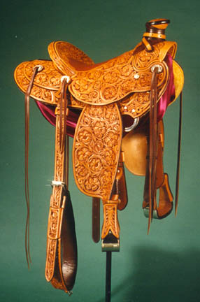

I made a wade youth saddle that weighed 23 lbs fully rigged with stirrups and cinchas. Last winter I made a full sized saddle on a 14" wide low moose that finished out at 26 lbs. The tree weighed 13 lbs! It would have been nice to have a lighter weight tree for that saddle.
Keith
23 # youth saddle
