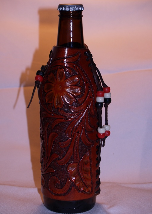

King's X Posted August 8, 2009 Report Posted August 8, 2009 (edited) Just as WhineWhine explained. Michael's sell the foam Koozie's for .66 cents each in different colors. I then used a craftaid with a Boston Terrier and just added a geometric tool to take up the rest of the space because a wallet craft aid will be a little smaller in circumference size. Also, here is a bottle koozie from a pattern given to our guild members last year from one of our saddle & boot shops. Apparently, they cannot keep them in stock. Edited August 8, 2009 by King's X Quote Greetings from Central Texas! The Grain Side Up blog #TheGrainSideUp
Members David Fields Posted August 8, 2009 Members Report Posted August 8, 2009 Just as WhineWhine explained. Michael's sell the foam Koozie's for .66 cents each in different colors. I then used a craftaid with a Boston Terrier and just added a geometric tool to take up the rest of the space because a wallet craft aid will be a little smaller in circumference size. Also, here is a bottle koozie from a pattern given to our guild members last year from one of our saddle & boot shops. Apparently, they cannot keep them in stock. Hello King's X Do you have a pattern for the bottle koozie that you wouldn't mind sharing? Thanks! David Quote

King's X Posted August 8, 2009 Report Posted August 8, 2009 Hello King's XDo you have a pattern for the bottle koozie that you wouldn't mind sharing? Thanks! David Let me find the paper pattern and check with the designer to release it. I will scan it and email it if you PM an email address. Quote Greetings from Central Texas! The Grain Side Up blog #TheGrainSideUp

Members Bear Posted November 7, 2009 Members Report Posted November 7, 2009 Just as WhineWhine explained. Michael's sell the foam Koozie's for .66 cents each in different colors. I then used a craftaid with a Boston Terrier and just added a geometric tool to take up the rest of the space because a wallet craft aid will be a little smaller in circumference size. Also, here is a bottle koozie from a pattern given to our guild members last year from one of our saddle & boot shops. Apparently, they cannot keep them in stock. Would you be willing to share the bottle pattern? Quote
