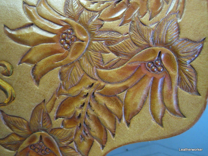

Members Leerwerker Posted August 20, 2009 Members Report Posted August 20, 2009 Here is an interesting timeline: First Picture - June 2004 - I colored the florals on the purse with Fiebings spirit based dyes. Next three pictures - May 2007 - three years later - most red and green color faded, brown gusset still OK - I redo one half of the purse with Eco Flo water based dyes. Tomorrow I will add the picture I took today so that you can see what the purse looks like today after more than two years again .... Quote

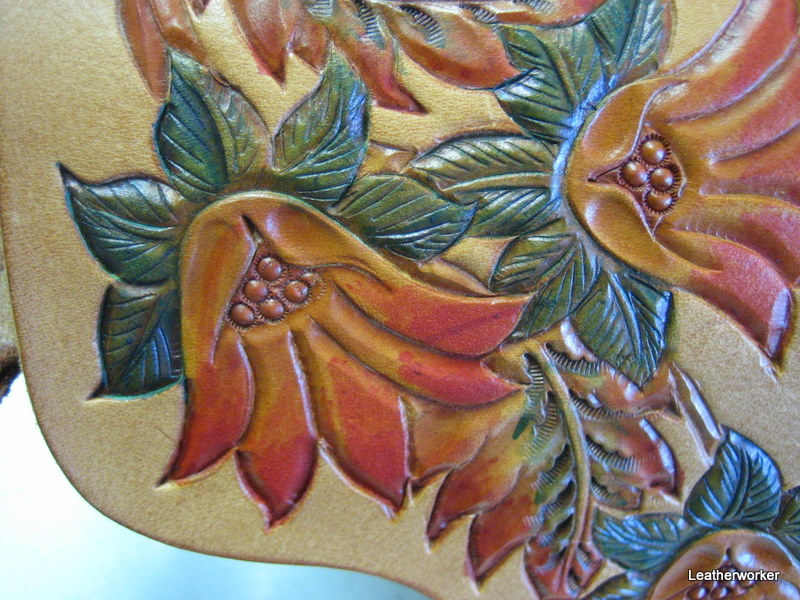

Members Leerwerker Posted August 20, 2009 Members Report Posted August 20, 2009 Here is the same purse yesterday: more than two years after I redid half the flowers in Eco Flow dyes: Quote
Members Rayban Posted August 20, 2009 Members Report Posted August 20, 2009 Here is the same purse yesterday: more than two years after I redid half the flowers in Eco Flow dyes: Looks good....what did you seal/finish it with?....and has it been used on a daily basis? Quote
Members Leerwerker Posted August 20, 2009 Members Report Posted August 20, 2009 Looks good....what did you seal/finish it with?....and has it been used on a daily basis? It hangs in my store and people handle it every day - I just treat it every six months or so with Dr Jackson's Hide Rejuvenator. Quote
