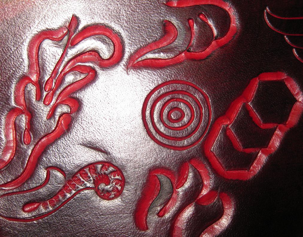

MADMAX22 Posted November 8, 2009 Report Posted November 8, 2009 (edited) Something that looks really cool and I like it better with browns then anything but looks good with black and red is dye the underlying lighter color then use the cotton shirt stuffed with cotton balls to take a darker color dye and skim over the top. When I do this with browns it usually is a saddle tan or tan underlayer and then a dark brown over layer. I have played with this with the red and black (actually ox blood and black) where the red went down first and then the high areas were black. Looks pretty slick. Heres a pic of a practice piece that I played with. Just getting a feel for the colors. Could of used a couple more layers of black but just wanted to see how it would look. Sorry about the crummy pic but you get the idea. Edited November 8, 2009 by MADMAX22 Quote
