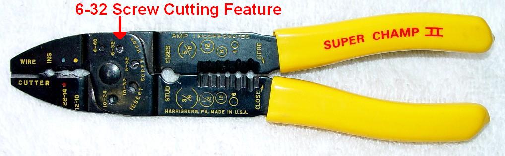

Members Bronson Posted January 2, 2010 Members Report Posted January 2, 2010 A handy tool to have around is a screw cutter. I went to the local hardware store and picked up a wire crimper/stripper that also has screw cutters on it. It looks like this... With one of these around if the screws you already have are a little long they can be easily trimmed to the correct length. Just be sure to put the screws into the cutter from the front (printed) side of the tool. Bronson Quote
