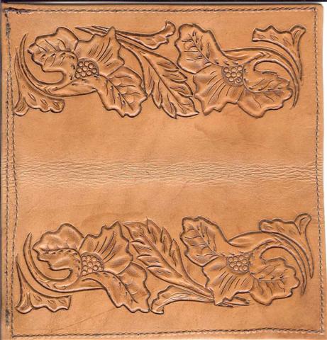

Tandy's has a good example "INVERTED CARVING" in free patterns. This here is not the best as was learning to sew.
  • Contributing Member

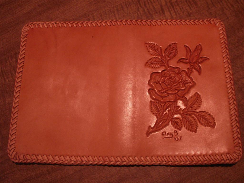

Here is another example of inverted carving. Al Stohlman did a book on inverted leather carving that also taught how to do sihlouette (SP?) and rough out carving. This rose pattern is one of my favorites out of that book. Peter Main also does a lot of inverted carving. It eliminates the need for a lot of backgrounding and gives a really clean look to your carving.
This is a link to the page where you can order Al's book.
http://www.tandyleatherfactory.com/products.asp?dept=63
Inverted Carving Book
6046-00 Al Stohlman's introduction to the art of silhouette and inverted carving. Learn the fundamentals of roughout carving. 48 large pages.
