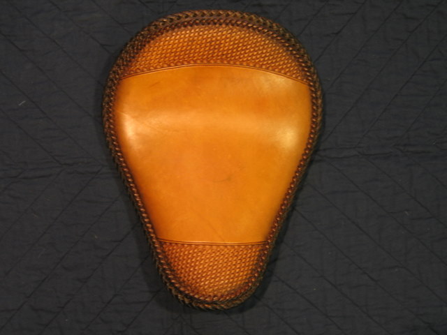

Contributing Member wolvenstien Posted January 14, 2008 Author Contributing Member Report Posted January 14, 2008 I feel for ya Wolvie, I do hope that you can get it all worked out.By the way, I thought you were going to go with a Dragon design on your seats? Ken I could not get anyone to hlp me with any type of design, and I saw either David or Beezes seat that was "elegantly simple" with basket weave tooling on the upper and lower of the seating area, and it looked nice, so since I could not get any help getting a scene that would bring all four pieces together, when I saw his seat I decided to go with something like that. It was posted on the 2007 board, and I dotn remember whose seat it was but I refered to it as "elegantly simple". I dont know if you allowed for this, but, when you use the cushion for the pattern and then punch holes and lace it together your NEW cushion size is measured to the inside of the holes. To make the cushion fit, you would have to enlarge your pattern by the distance from the inside of the holes to the edge of the leather. for example if your cushion is 15" square and you use 1/8" dia. holes that are 1/8" from the edge of the leather your pattern should be enlarged by 1/4" on all sides or 15 1/2" square. David, no I did not take this into account, and thank you for giving me the formula to figure it by... maybe now when i restart on it tomorrow I will get it to work. Quote "The miracle is not how two adults can create a child, the phenomenon is how quickly a child can create two adults." -- VYBE Her: Hit Me Him: Do you want me to use the knife? Her: No, When you hit with a knife, that's STABBING!
