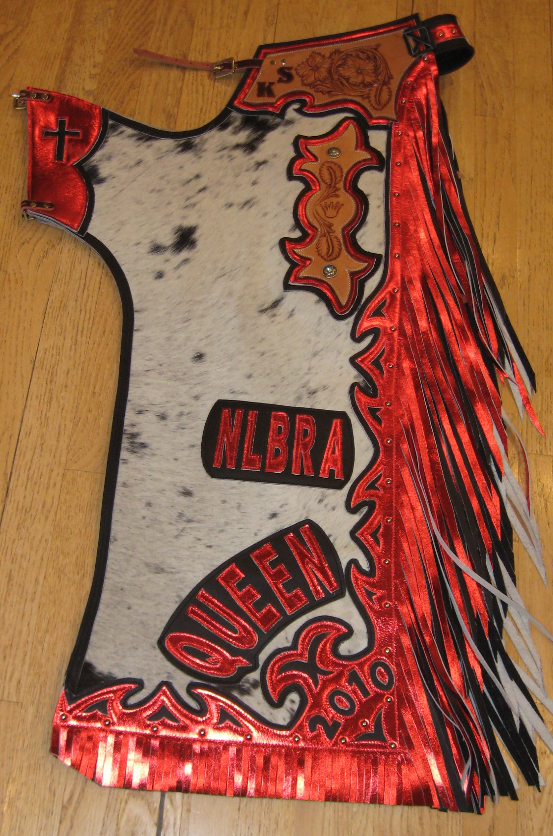

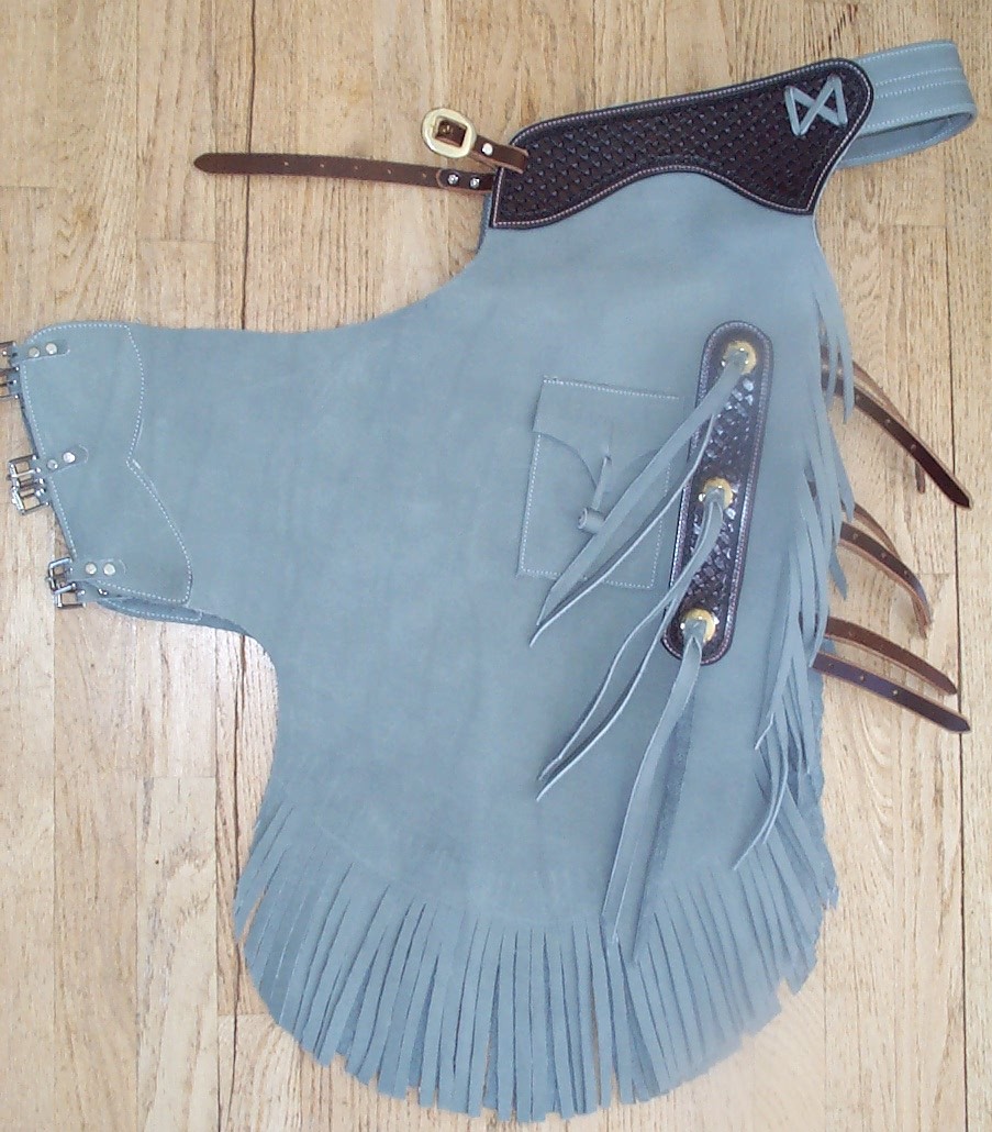

Members Dink Posted May 4, 2010 Members Report Posted May 4, 2010 A few new rodeo, chinks and queen chaps, any comments will be appreciated Thanks Dink Quote
Members GrampaJoel Posted May 4, 2010 Members Report Posted May 4, 2010 Very nice! Who do you get your Metalisc leather from? Quote
Members Dink Posted May 4, 2010 Author Members Report Posted May 4, 2010 I get my metallics at either Seigel or the hide house. Dink On 5/4/2010 at 5:37 AM, GrampaJoel said: Very nice! Who do you get your Metalisc leather from? Quote
Members GrampaJoel Posted May 5, 2010 Members Report Posted May 5, 2010 Thank you very much for the info. That red metalic is totaly glowing! Quote
Members Penden Posted May 5, 2010 Members Report Posted May 5, 2010 I also love the red, but I love the others too Quote
Members bhansen05 Posted May 5, 2010 Members Report Posted May 5, 2010 They look very good. I love the tooling on the queen chaps. It looks really nice. I actually have a pair of chinks from you and they have been great. Very durable and still look really nice. How do you make your pocket hook? I've tryed to get the leather to roll up as tight as you but by the time i get the tail threw it it is loose. Help with this would be great. I love how they look and work. Quote Like 3H Custom Leather @ facebook.com
Members Dink Posted May 5, 2010 Author Members Report Posted May 5, 2010 I think the best suggestion I have for the first ones is determine the strap amount needed for the size button you want, and then glue it and roll it tight and clamp it until your glue sets up then you make your hole an put the narrowed strap end through. I have not found an easy way to feed it through yet, I cut my hole from both sides with a bleeder knife then reach through with a pair of forceps. another way that I have done the pull through is by using the old type buckstitch needles that are hollow and have threads in them and can screw onto the end of the strap. Hope this is helpful. Dink On 5/5/2010 at 12:10 PM, bhansen05 said: They look very good. I love the tooling on the queen chaps. It looks really nice. I actually have a pair of chinks from you and they have been great. Very durable and still look really nice. How do you make your pocket hook? I've tryed to get the leather to roll up as tight as you but by the time i get the tail threw it it is loose. Help with this would be great. I love how they look and work. Quote
Members bhansen05 Posted May 5, 2010 Members Report Posted May 5, 2010 (edited) Thanks a lot for the help. Ill give that a try. On 5/5/2010 at 3:46 PM, Dink said: I think the best suggestion I have for the first ones is determine the strap amount needed for the size button you want, and then glue it and roll it tight and clamp it until your glue sets up then you make your hole an put the narrowed strap end through. I have not found an easy way to feed it through yet, I cut my hole from both sides with a bleeder knife then reach through with a pair of forceps. another way that I have done the pull through is by using the old type buckstitch needles that are hollow and have threads in them and can screw onto the end of the strap. Hope this is helpful. Dink Edited May 5, 2010 by bhansen05 Quote Like 3H Custom Leather @ facebook.com
