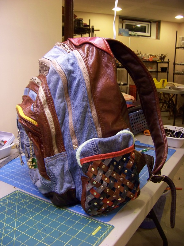

Members leatherkind Posted September 15, 2011 Members Report Posted September 15, 2011 I am glad i found leatherworker.net and I enjoy reading it very much. It was difficult for me with no experience in sewing to make a sewing machine choice. Thanks to all contributors here and especially to Wizcrafts' posts I was able to make an informed decision. This summer I acquired a Cowboy 4500 from Bob Kovar and it was a lot of fun making different items on this machine. Here is one project that proved to me that i got the right machine. It is a leather and jeans backpack. (please see the attachment) Even though it is relatively light duty bag there are several tough spots in it. There are folds of thick leather on top of heavy nylon fabric together with some thick jeans folds. Many of those layers are with glue between them. Some spots are at least 1/2 inch of very stiff material to get through and the machine showed no stress at all. Just do not press the pedal too hard or it will go too fast to properly control the material. I am very glad that i got this machine.
Moderator Wizcrafts Posted September 15, 2011 Author Moderator Report Posted September 15, 2011 (snip) Here is one project that proved to me that i got the right machine. It is a leather and jeans backpack Even though it is relatively light duty bag there are several tough spots in it. There are folds of thick leather on top of heavy nylon fabric together with some thick jeans folds. Many of those layers are with glue between them. Some spots are at least 1/2 inch of very stiff material to get through and the machine showed no stress at all. (snip) What size, or sizes of needle and thread are you using to sew these awesome backpacks? Posted IMHO, by Wiz My current crop of sewing machines: Cowboy CB4500, Singer 107w3, Singer 139w109, Singer 168G101, Singer 29k71, Singer 31-15, Singer 111w103, Singer 211G156, Adler 30-7 on power stand, Techsew 2700, Fortuna power skiver and a Pfaff 4 thread 2 needle serger.
Members leatherkind Posted September 16, 2011 Members Report Posted September 16, 2011 What size, or sizes of needle and thread are you using to sew these awesome backpacks? I used #22 ball point needle and T135 nylon thread and harness presser foot assembly. This choice was made after #20 needle bent on a first try and #22 was the largest ball point I had on hand at that time. I had larger needles but those were all for leather and i have heard somewhere that they will cut the fabric and the seam will not be strong. T135 was used because i like thick threads but bigger thread would adversely affect gentle feel of this very soft leather. I used Harness Foot because this is the only one i have. Your question however prompted me to investigate effects of different needles on nylon fabric. For the experiment I used 0.15 mm nylon fabric (0.0065"), #22 ball point, #23 spade point, and #25 triangular point needles. It is not exactly apples to apples comparison but i think it is enough to prove my original assumptions wrong. None of the needles seem to inflict any damage on the fabric which was a total surprise to me. Only the largest needle caused threads to pull in cross shape which i do not think can be considered a mechanical damage. I do not see any evidence of cutting. It seems that i was wrong and I could have used leather point just as well and achieve different type of stitch. The experiment is not ideal however because i did the puncturing by hand. I will try it on the machine under normal conditions if I do not forget. PS Thank you question and for your opinion about the backpack.
