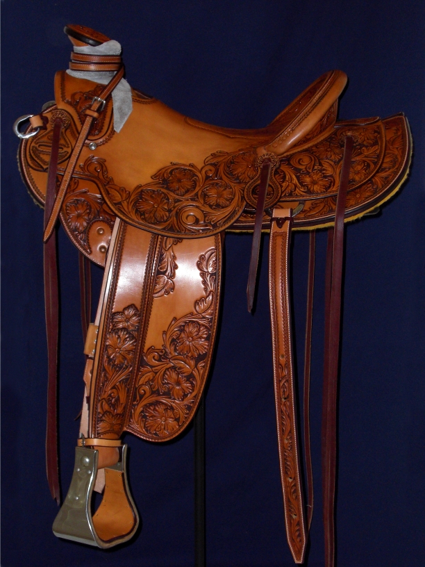

Members RWB Posted July 13, 2010 Members Report Posted July 13, 2010 Here is a saddle that I just finished. I am getting really sick of building Wades, but the next three or four are swell forks. So things are looking up. As usual I have pretty thick skin. If you see anything you don't like, then fire away. I like the criticism so don't hold back. Ross Quote
Members D.A. Kabatoff Posted July 13, 2010 Members Report Posted July 13, 2010 Ross, that is a fine looking saddle! Good looking seat shape, nice balanced lines, and tastefully decorated. I think if there was one thing to pick on it would still be the front jockey corner... my taste is for a more rounded corner. Other than that I'd say great work! Darcy Quote
Members Billy H Posted July 13, 2010 Members Report Posted July 13, 2010 That is a beautiful saddle!!! Regards Billy Quote
Members wvcraftsman Posted July 13, 2010 Members Report Posted July 13, 2010 WOW! Great looking saddle. I'm not a saddle maker.....I sure hope to build one some day (so does my wife). When I do, I hope it turns out half as nice as that one. Quote
Members BondoBobCustomSaddles Posted July 13, 2010 Members Report Posted July 13, 2010 Well done! I echo Darc's comments, and also like my jocky's rounded more in the front. All in all very nice. What do you use for resist when you are antiqueing? Bondo Bob Quote
Members RWB Posted July 13, 2010 Author Members Report Posted July 13, 2010 (edited) Thanks I appreciate what you guys have to say. Bob, I just use Neat-Lac. I went out and bought a bunch when they said they were not going to make it anymore. I've used that Clear Lac, but I'm not real hot on it. I know that it is supposed to be the same formula, but I'm not convinced. I strips dye easier than Neat-Lac. I haven't tried that Wyo-Sheen that Sheridan Leather is selling. Clear Lac works fine and makes a great top coat. I'm just to picky I guess. I'll have to think about that front jockey. I just have a hard time not putting a straight line there. I like that flow that is has thru the seat jockey to match up with the back housings. I don't know, I'll have to study on that. Ross Edited July 13, 2010 by RWB Quote
