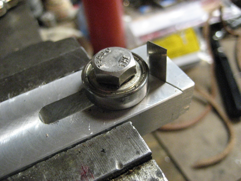

Since I make all of my projects from scrap leather one of the things I do with a lot of it is cut it into lace for braiding and lacing, etc. Since I make my own lace from scraps it's more often than not to thick to really be used for braiding. So I made this simple lace thinning and beveling tool today. Made from some scrap aluminum left over from a casting project, a 608 rollerblade bearing, a 5/16-18 bolt, and some 4-40 screws. The bearing end has a 20 degree angle on it and the blade is held clamped between the end piece and the main body, the other end has a 30 degree angle from top to bottom for beveling. I get tired of the cost of injector blades so I make my blades from inexpensive single edge razor blades. I clamp them between two pieces of metal and use a third, the length of the razor blade, to snap them off, making a blade the same size as the injector blades. Only takes a second to do and saves me a bunch on blades. I also use these in my tandy lace cutter.
When I make lace I start with a tandy lace cutter then use this to thin and bevel the lace.

Nah, you're not stupid, I could see where it would be confusing not seeing it work. Basically to thin the lace you loosen the bolt through the bearing, the bearing slides towards or away from the blade, and the lace is run over the bearing and under the blade.
I'll try and get some pictures.

Here are some pictures to show how it's used.

The bearing has 1" of travel, so you can use it to cut strips to different widths as well as thinning them. However, since all of it I make I use for either braiding or lacing I haven't tried thinning down anything wider than lace. Theoretically you should be able to stack several bearings on top of each other to make the rolling surface wider, what I haven't tried is to see how flexible the blade will be sticking out farther. I guess that needs to be an experiment in the near future.

Thanks for the pictures. It makes sense on how it works now.
