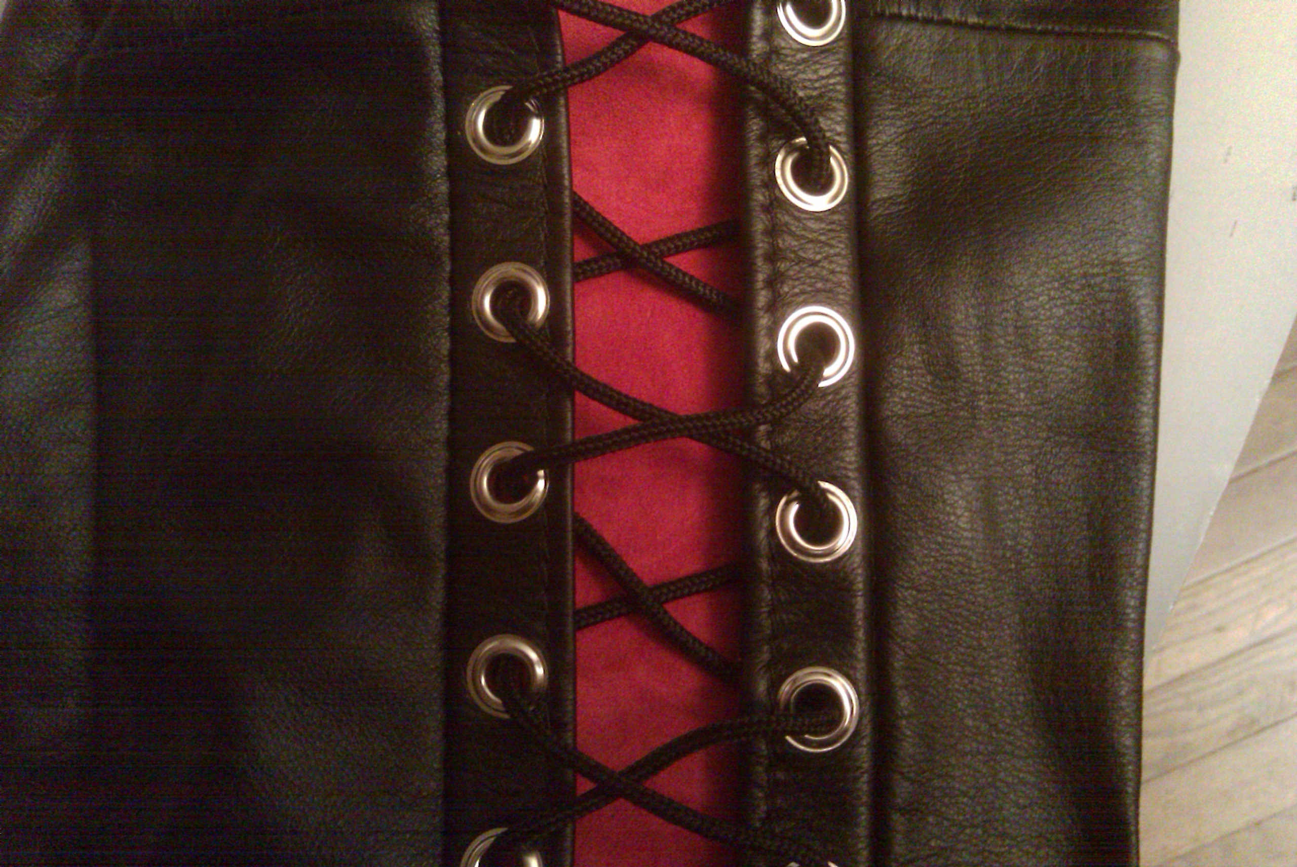

I found a pant lace up section pic.
post-15465-067457700 1280739853_thumb.jp
