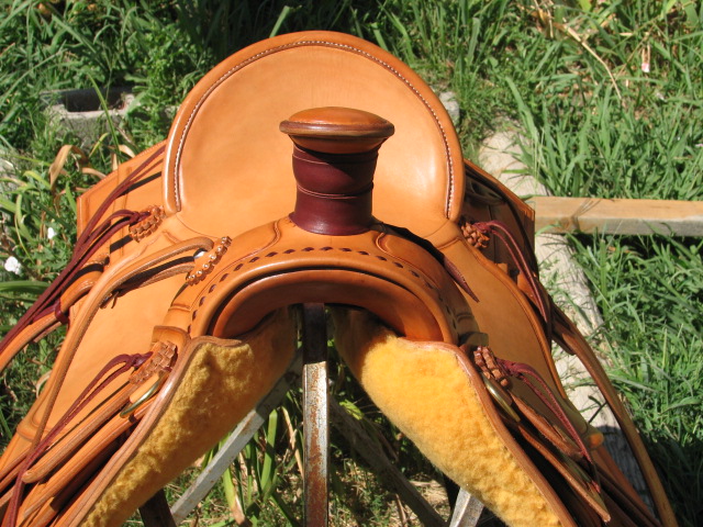

Steve Brewer Posted August 12, 2010 Report Posted August 12, 2010 Just finished this saddle today.It is a 16"seat 3b,5 x 11" cantle,no.5 dally horn,3/4 flate plate rigged,with pointed shirts.Creased a double line around the borders. Saddle made up nice Quote
Members loopinluke Posted August 12, 2010 Members Report Posted August 12, 2010 I really like that saddle. Your lines are perfect, and its amazing to me that you can have that much untooled leather without a scratch or blemish on it. Your experience shows, and that should make somebody a hell of a nice rig. Quote
hidepounder Posted August 12, 2010 Report Posted August 12, 2010 Saddle looks great Steve! Loopinluke is right....you did a great job of keeping everything looking clean. What did you use for oil and what kind of finish did you use? Bobby Quote
Steve Brewer Posted August 12, 2010 Author Report Posted August 12, 2010 Saddle looks great Steve! Loopinluke is right....you did a great job of keeping everything looking clean. What did you use for oil and what kind of finish did you use? Bobby Bob,I used olive oil and sunshine,followed by a coat of Neatlac Quote
Members D.A. Kabatoff Posted August 12, 2010 Members Report Posted August 12, 2010 Nice Saddle Steve... without any carving it has a refined look to it that shows your fine workmanship. Darcy Quote
gtwister09 Posted August 12, 2010 Report Posted August 12, 2010 Steve, As others have said a great saddle with clean lines. Regards, Ben Quote
Ambassador pete Posted August 13, 2010 Ambassador Report Posted August 13, 2010 Just finished this saddle today.It is a 16"seat 3b,5 x 11" cantle,no.5 dally horn,3/4 flate plate rigged,with pointed shirts.Creased a double line around the borders. Saddle made up nice Great work! Again!!!! Tell me please- HOW do you make your double creases?!!! What tool do you use . I have an adjustable creaser(cheap Tandy with a screw adjustment) . Do you have to bevel each side? pete Quote
Steve Brewer Posted August 14, 2010 Author Report Posted August 14, 2010 Great work! Again!!!! Tell me please- HOW do you make your double creases?!!! What tool do you use . I have an adjustable creaser(cheap Tandy with a screw adjustment) . Do you have to bevel each side? pete Pete ,I cut the border with a swivel knife and then crease it with a Beader.On this saddle I beveled the crease with a cheakered beveler. Quote
Members Traveller Posted August 15, 2010 Members Report Posted August 15, 2010 Thanks for posting these pics, Steve! I never tire of seeing your saddles. Great lines, as always. Quote
Members Billy H Posted September 3, 2010 Members Report Posted September 3, 2010 Hi Steve, Missed this post until tonight. I like it alot! If you do not mind me asking, what is the difference between a 3b and a Weatherly - I look at both and to me they look the same. Thanks Billy Quote
