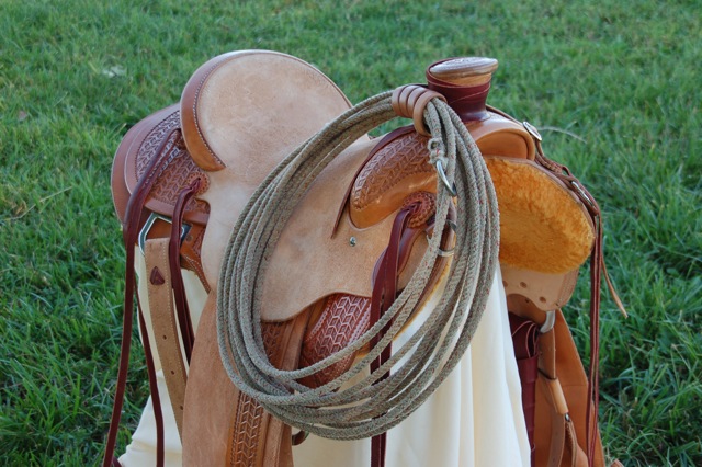

This is my second saddle and I learned so much even from this one. I can't wait to get started on my next one. Edited by seveneves

You did one a really nice job on it.

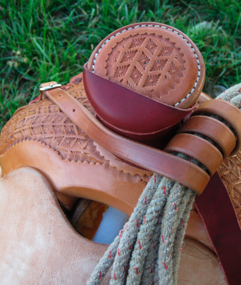

Very interesting pattern, never seen that before. Do you have a close up of the tooling pattern?

That saddle looks really nice. But I have to ask. What makes it the type of saddle you call it?
Can you point out the features that make it what you call it?

post-13207-010099300 1285298612_thumb.pn
Nice saddle!
Thanks Casey. It's a Jeremiah Watt stamp and I just played around with it and came up with this. It was super hard to get it looking even consistent. I sure waisted a lot of leather getting it right. post-13207-065806400 1285298593_thumb.pn

I just call it a lewis roper because that's the kind of tree it's built on. I just call it #2 because it's the second saddle I've built. Sonny Felkins is a tree maker in Southern Utah. I'm not sure if that anwsers your questions but if not let me know.

This was a long process for me to get the stamping down right. At first I would score a line but then after a while it would start to warp. So I made a design in Photoshop then I printed it out and pasted it to some vinyl. Then I tool a razor and cut out my pattern which was about 4 inches. Then I laid it out on the cased leather and rubbed the impression into the leather. From there I would simply stamp over top of the light impression. It keeps things straight and true.

Thanks for the closeup pictures. Now I can see the tool you used. Also thanks for explaining how you tooled it in a later post.
