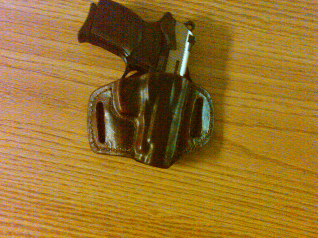

Members PHIPPS CRAFTED LEATHER Posted December 1, 2010 Author Members Report Posted December 1, 2010 (edited) Ok, good suggestions. Now when do you apply the sheen product? Before wetting and moulding, before you dye, before you sew together. Also here are pics of my newest holster for the same weapon. GrampaJoel: I recommend against using sandpaper on surfaces that will end up in contact with a good handgun. Grit particles can become lodged in the leather, remaining there to work as an abrasive on the handgun's finish. For minor roughness or fuzz on the flesh side I recommend any of the acrylic sealants (leather sheen, super sheen, etc), sponged on then slicked down. For serious roughness, it is time to find a better supplier. Best regards. Edited December 1, 2010 by PHIPPS CRAFTED LEATHER Quote
