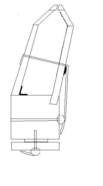

Hey all, I am trying to design a stitching pony that I can clamp to my workbench that can be easily stored in my tight space, So far this is what I came up with. Its kinda rough but I think you can get the general idea. I want it to have the cam locks and be able to swivel . Also it will have angled legs that I can just drill some holes into that will match holes i will drill into my bench leg to put pins into to be able to adjust the height so i can sit or stand while i'm doing my stiching and stuff. I geuss i'm just trying to find out what a good distance from the clamping leather to the top of the jaws should be (I'm thinking twelve inches), and what cant should the jaws be (75-80 degrees maybe). like I said the jpeg is rough cuz i'm not on my home comp. Any ideas from all of you would be spectacular and greatly appreciated. If I can reinvent the horse so to speak I think I might try to sell these.

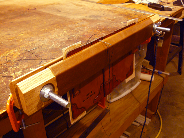

Here's one I came up with a couple of years ago that might fit your need. I've got a tutorial around here somewhere to build one... it doesn't swivel but it's simple, clamps to a bench, and stores away neatly.

Kate

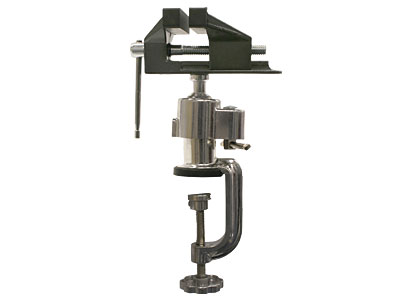

I use one of these on my desk for smaller projects, though I have done large costrels with it. I have been thinking about extending the jaws somehow. Its really good in the it swivels on a ball koint so you can position the work in any axis.

Kate,
If you find that tutorial point the way, please.
Sparks
Kate

Here's the original post I made on this:
http://leatherworker.net/forum/index.php?showtopic=4923
Then later I found a better way to mount the clamp, using corner brackets. You can see how that looks here:
http://leatherworker.net/forum/index.php?showtopic=6380
Kate
http://leatherworker...?showtopic=4923
http://leatherworker...?showtopic=6380
Kate
