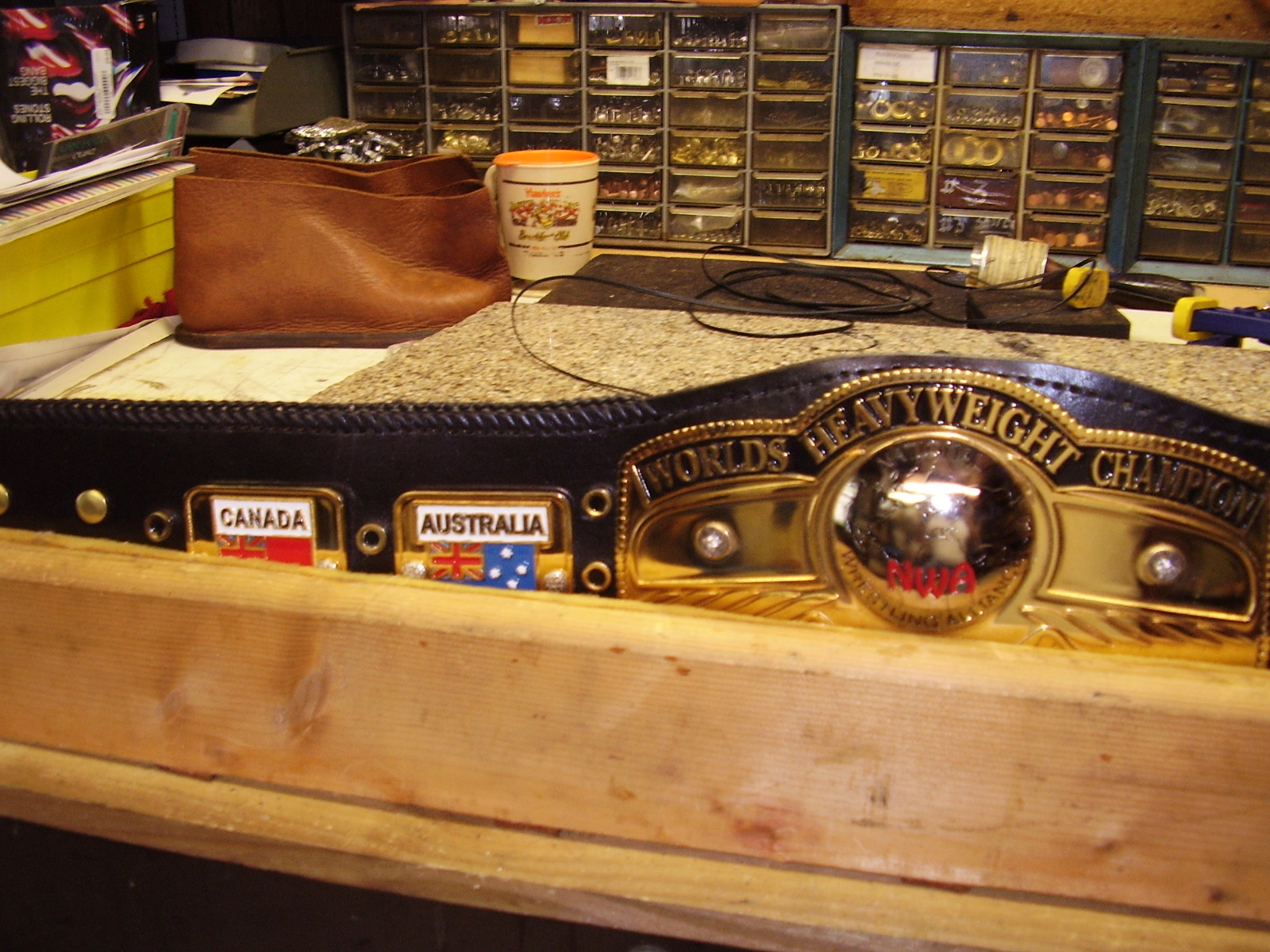

Members CitizenKate Posted September 11, 2008 Members Report Posted September 11, 2008 After noticing some of the discussion about stitching apparatus, I thought I would share a half-baked idea I came up with a few years ago that turned out to be pretty useful. The traditional stitching pony/horse designs were not working for me, because some of my pieces are way too large to fit in them. This is an extra-long stitching clamp which can hold any size piece from wallet sized all the way up to around 36" wide. And since there is no apparatus below it, other than the floor, it can hold a piece very long as well. It mounts on the edge of my bench with a couple of F clamps. It was made with two 2x4's: - I beveled one edge of each with a router fitted with a chamfer bit. The beveled edges make the work more accessible to your hands. - Then drilled two holes in each for the bolt and wing nut. - Then wrapped them with upholstery leather to provide some cushioning for the work being held. Only one half of the clamp is mounted to the edge of the bench. The other half is free to move. Kate Quote

Hilly Posted September 11, 2008 Report Posted September 11, 2008 (edited) That IS a great idea! Not only can you do large items, you don't have to move them after every few inches of stitching! Thanks for sharing! You're giving me some ideas for my work space... I use something somewhat similar to this as a 45 degree beveling jig for beveling large pieces. I think I will install a "lip" under my work bench, and install bolts through it with wingnuts that will fit, and eliminate the clamps. That way I can switch between "stitching apparatus" and beveling jig. All I'd have to do is drill holes through both of them so that they'd fit on the bolts... Hilly Edited September 11, 2008 by Hilly Quote

Ambassador Luke Hatley Posted September 11, 2008 Ambassador Report Posted September 11, 2008 I had to have a third hand to help with the wrestling belts, it helped me by about 3 hours. Quote Luke

Members CitizenKate Posted September 11, 2008 Author Members Report Posted September 11, 2008 Oh, by the way, Windy made the astute observation that the boards I used are not 2x4's but more like 1x2-1/2. Kate Quote
