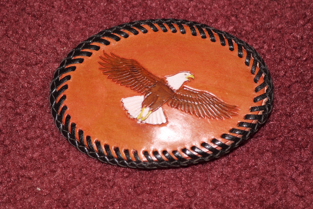

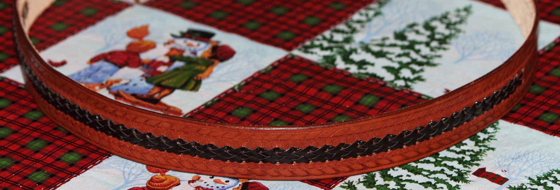

Tried this because I saw it in the Tandy Skiver newsletter. The belt is embossed and was used as a trial for the braiding concept.
I like it, it is different. Has potential for decorative braiding on instrument straps, belts, etc.

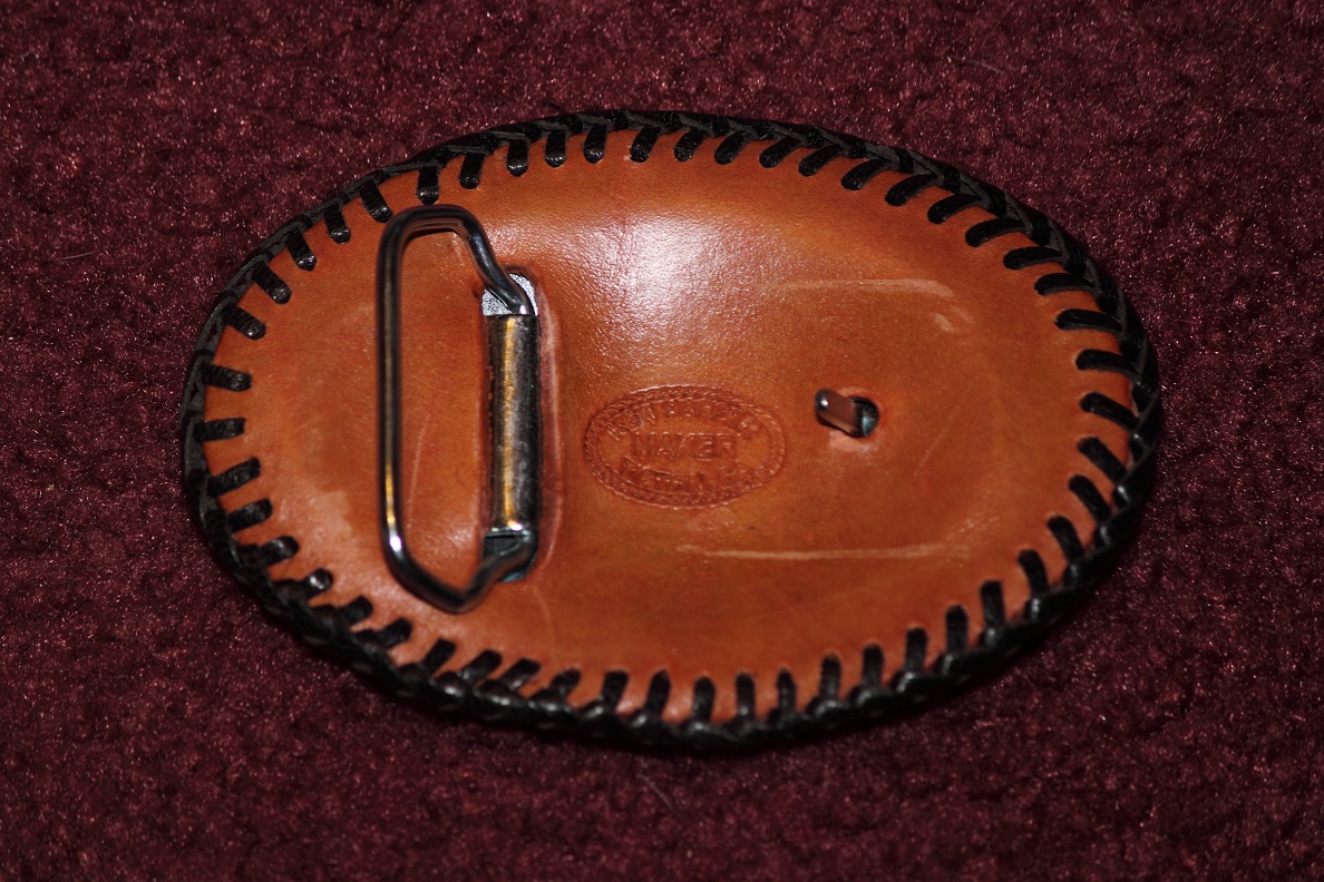

Bevan,
I like your's better, the pattern in the Skiver was with two holes and two strips of leather, I'd be interested in knowing how many holes and what the braid pattern was on yours, additionally what it looks like on the reverse side..
Nice work, did you use Kangaroo lace?
Ken

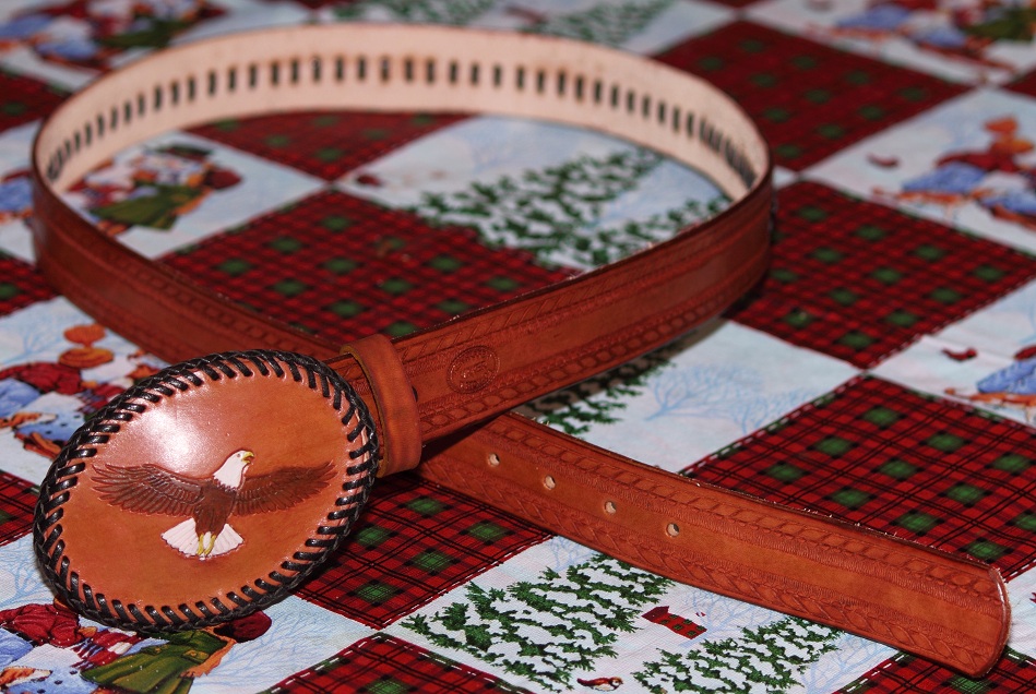

good work on all the applique examples. :thumbsup: now i've had to add one more item to the list of things i need to learn.
ken, about how long did it take you to do the braiding on your belt? it matches up nicely with your buckle.

Ken,
Not as long as you'd think, maybe an hour on the actual braiding, definitely not more. It took longer to layout and punch the holes, this braid requires 2 lines of holes spaced 3/8" apart with the holes spaced 3/8" apart on the lines. I used a 1/8" punch so the actual braiding goes very quickly. If you get the Skiver newsletter from Tandy the instructions are in the latest one, if not let me know and I can send you a copy of the instructions via email.

Love the braiding , put it on the list , thinks to learn.

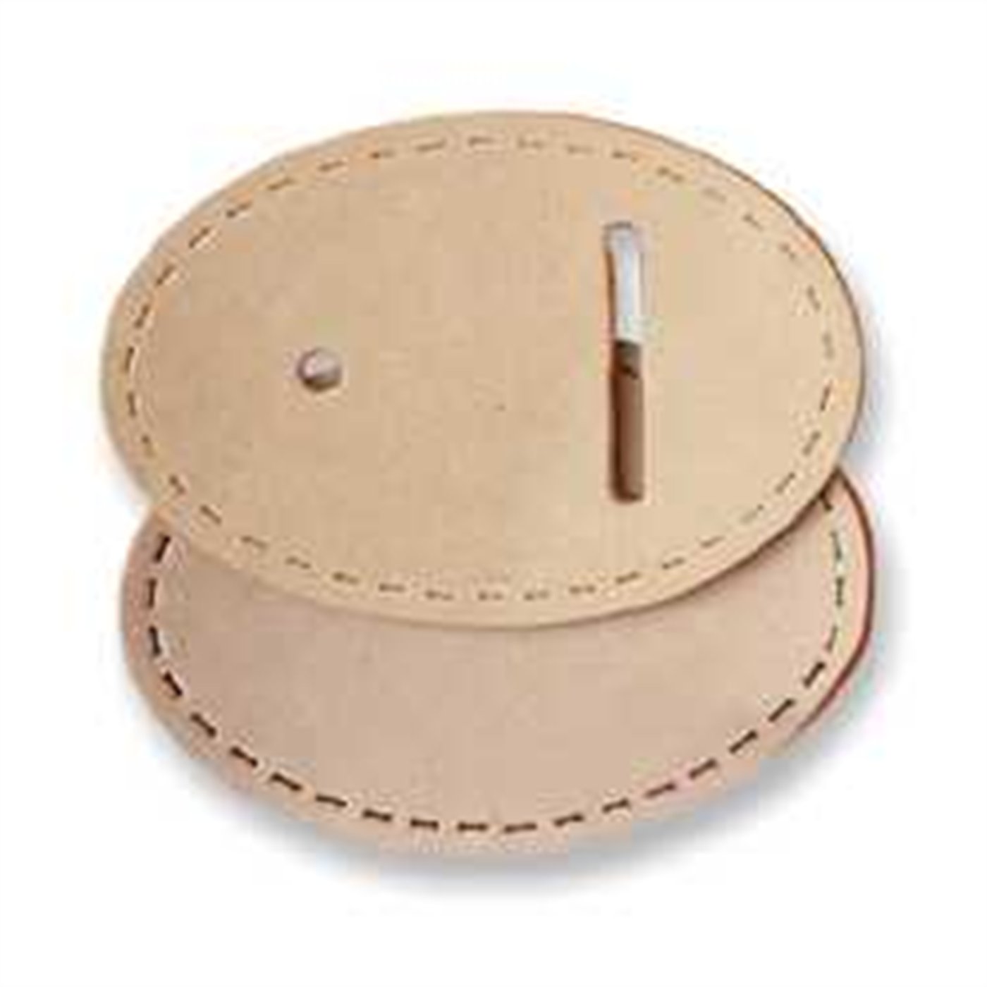

Great buckle Ken, which buckle did you use as hardware?
Did you glue the leather on it?
