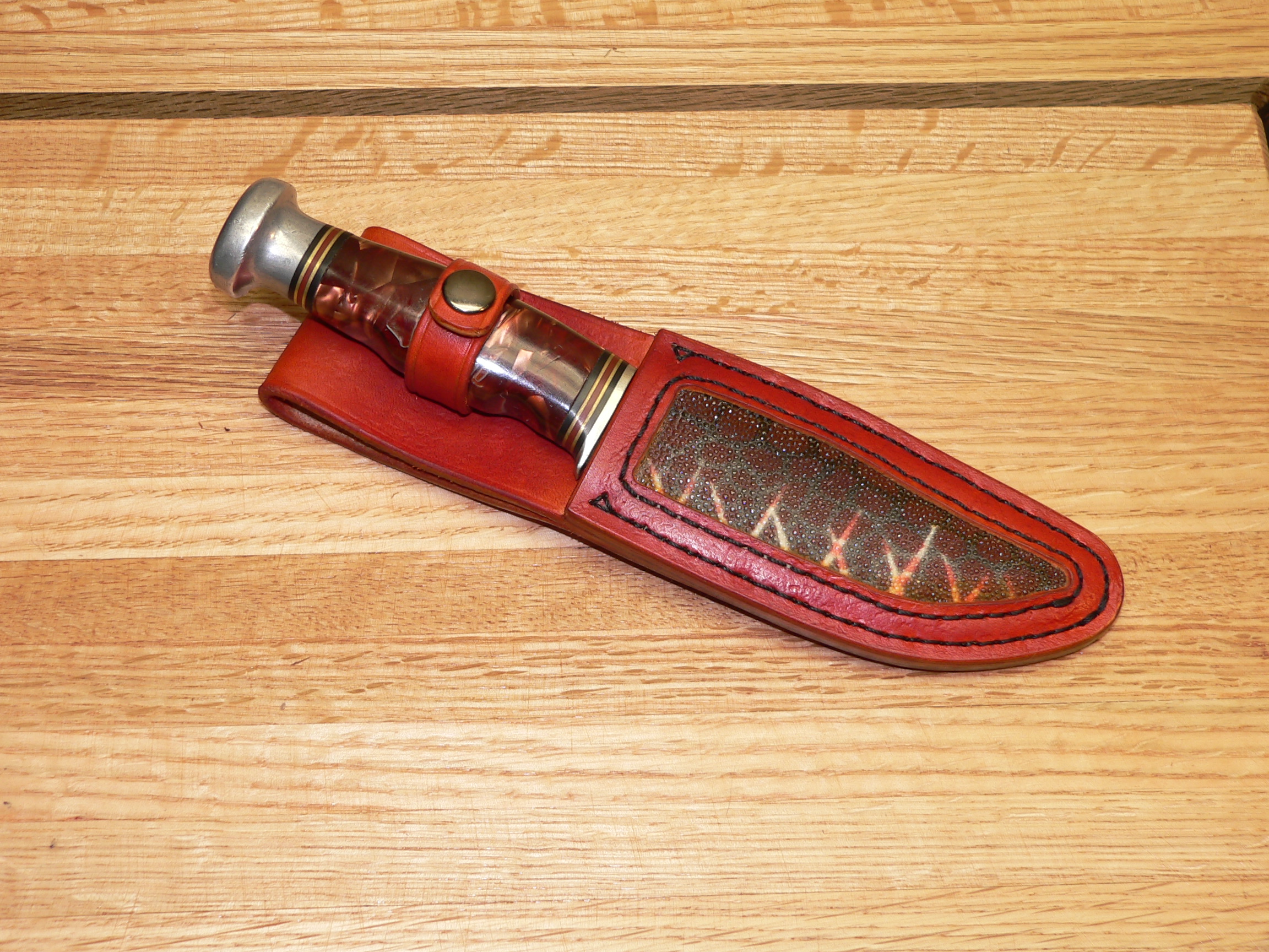

electrathon Posted January 16, 2011 Report Posted January 16, 2011 You might consider sewing the back instead of riviting. Over time, the rivits will scratch the finish off the phone where ever it touches. Also included a knife scabbard idea. Aaron Quote

Members treadhead1952 Posted January 16, 2011 Author Members Report Posted January 16, 2011 Hi Aaron, Yeah, they include a pad of some soft fuzzy material with a self stick back to it to protect your cell phone from getting scratched up. I was considering some stitch work on this second one rather than the rivet action, I like sewing this stuff up. That is a nice looking sheath, I like the insert, what is that, Ray? Thanks Mtn, Man, it has been a long while since I did anything in the way of stamping or leather construction. With all the knives I have and other stuff, it is just time to get busy again. Quote
electrathon Posted January 17, 2011 Report Posted January 17, 2011 Yes, the inlay is stingray. There is a short trimmed layer of sheepskin behind it to mape it "poofy". Quote

electrathon Posted January 17, 2011 Report Posted January 17, 2011 Jay, If you are harvesting your own, this is more in line. Likely not many stingrays near to you. The inlay was a rattle snake I bought off ebay a couple years ago. One of the best tools you can buy for cleaning up your edges is a drywall sanding sponge. You can smooth out your jerky cuts easily. Plus they are cheap and easy to get. I like the metal clip better than a loop, just in case I need to pull it off my belt. Definatly a personal preferance. I used a thin maget for the closer. Velcro will wear out over time opening and closing it, the magnet will not. Your basket waeve is sideways. It should go side to side, not top to bottom. Aaron Quote
