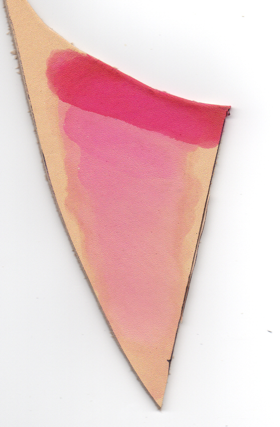

Angelus has a pink spirit dye that works great. The different amount of reducer you use will give you as manny shades of pink you like, all from very hot pink to suttle baby pink.
The call the color "Light Rose" and the swatch at the web page does not give the true color, it's much more vivid in real life.
I can go down later on today and make a swatch for you and shade it from one end to the next :-)
http://turtlefeathers.net/text/angelus/dye.html
Oki, Here the scanning I prommised to post...
Thanks Tina that is just what I was looking for.
thanks Tina i just placed a order
