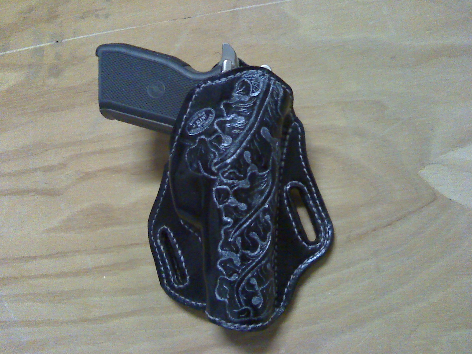

FWIW from a grumpy old man. I make almost all of my holsters from double layered leather. Depending upon how large the gun is, the 7/8 oz may not be too thick for you to salvage a pretty good rig. I use Weldwood contact cement to bond the flesh sides of the leather together, then proceed as with a single thickness. Stitching can be problematic for one unaccustomed to it, but it can be done. You will not be able to get sharp 'boning', however, with good hand forming and proper drying you will find that you have created a very solid and firm holster. Much more so that any single thick holster...IMHO. A couple of holsters made from double layer work ups........both use 4/5 as the lightest and up to 7/8 as an outer shell. Mike
