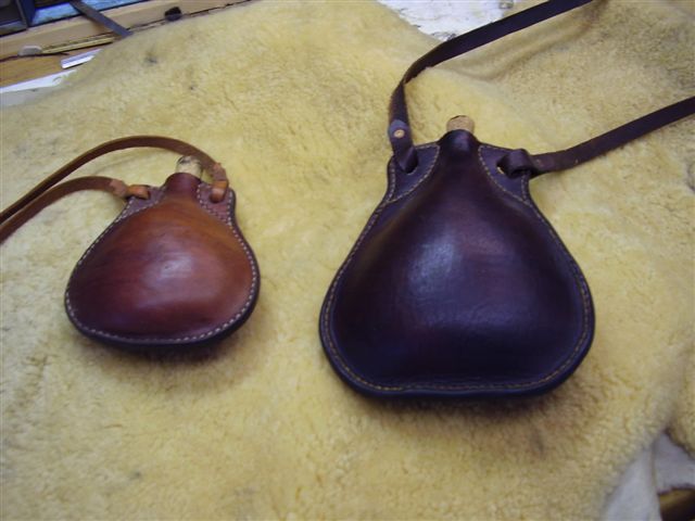

Members MMArmoury Posted August 22, 2010 Members Report Posted August 22, 2010 Finally finished my first ones! I already sold some this weekend and they were a hit, lots of interest in them. Quote
